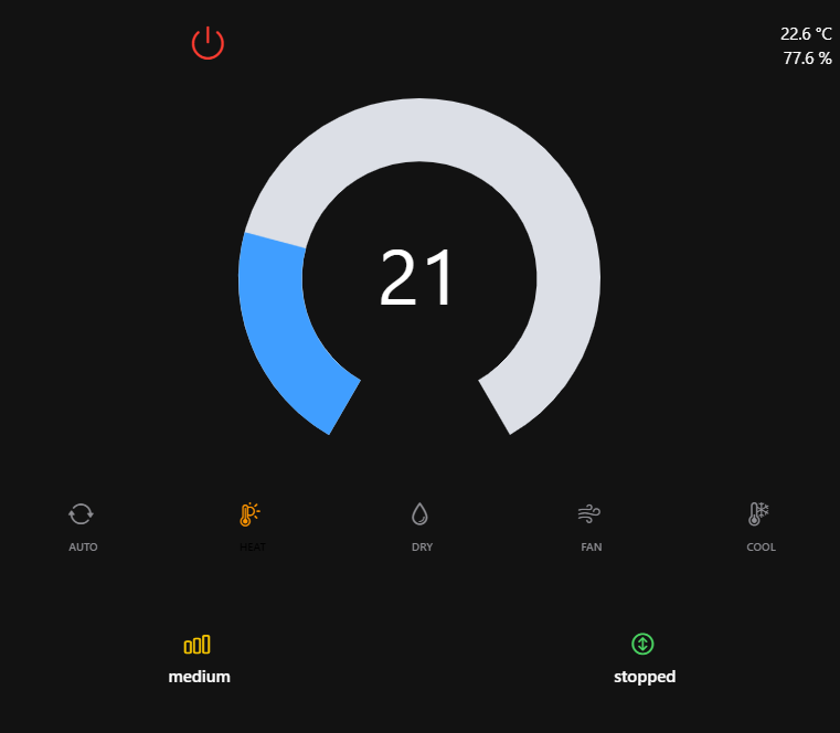

I’m thinking of a screen that can work with an air conditioner like Sensibo

Would the thermostat control not do for that then? It currently has on off and temperature adjustment?
Yes but in an air conditioner the temperature is between 16 and 32 degrees
And need to change the hue of the temp unit
That might be possible. Running the control in hot or cold mode, which renders it a little different, ill have a think about that. Sounds doable
