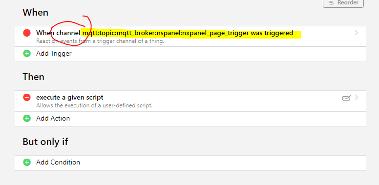

I’m getting this error message
2022-02-13 22:20:39.666 [ERROR] [internal.handler.ScriptActionHandler] - Script execution of rule with UID ‘5f3b7c9005’ failed: javax.script.ScriptException: groovy.lang.MissingMethodException: No signature of method: org.openhab.core.items.events.ItemStateChangedEvent.getEvent() is applicable for argument types: () values:
Possible solutions: getAt(java.lang.String), getClass(), getTopic(), getType(), every()
I think you added the rule to the wrong thing. It’s not the item, it’s the channel you add it to directly. it’s trying to call method of the event, as thought it was a channel event. since you are triggering it off an item, it’s an item event. and that does not have the same methods which the rule is expecting.
This is my trigger for that rule

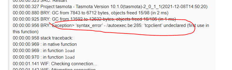

I changed the .be file and now I can not sync the unit with OH
I get {“Command”:“Unknown”} in the console of tasmota
Please send the log file with “weblog 4” set. when you think it’s trying to sycn, so I can see the message to and from the nxpanel.
16:56:51.397 CMD: InstallNxPanel
16:56:51.412 MQT: stat/tasmota_7DDCCC/RESULT = {“Command”:“Unknown”}
you need to send more of the log so I can see what lead up to that. and enable detail logs by typing
weblog 4
needs enabled by entering that in the tasmota console, so you can see what was sent to result in that message.
It would be better to type;
restart 1
which reboots the device, then send me all the logs from the boot until the error. So I can see the issue.
did you reboot after putting the new nxpanel.be file there? It kinda looks like it’s just not using the new one.

00:00:00.956 BRY: Exception> ‘syntax_error’ - /autoexec.be:285: ‘tcpclient’ undeclared (first use in this function)
00:00:00.958 stack traceback:
00:00:00.969 : in native function
00:00:00.969 : in function load
00:00:00.970 : in function load

this is wrong.
I download the nxpanel.be from the git location and reinstalled on mine. it’s def right one.
you def have this?
I’d make sure you are on a current tasmota too.
