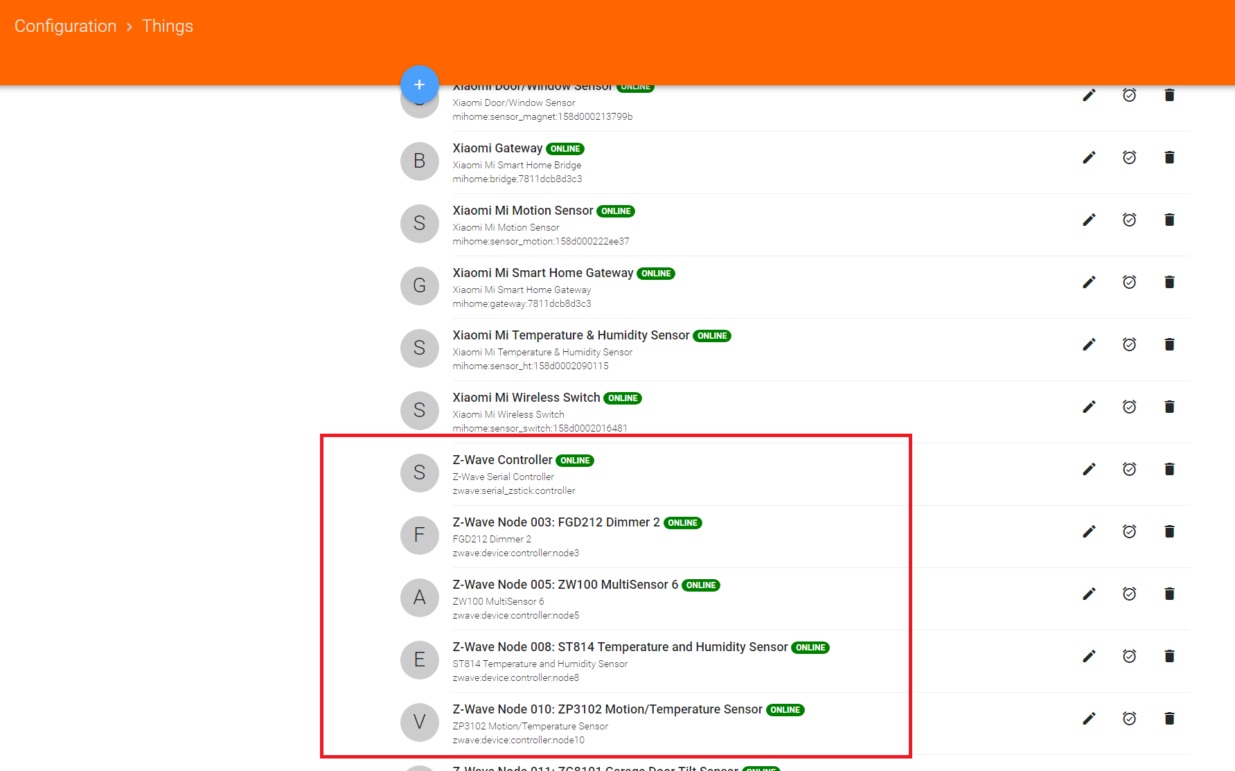

Bridge zwave:serial_zstick:controller "Z-Wave Controller" @ "Z-Wave" [ port="/dev/ttyUSB_ZStick", controller_softreset="false", controller_master="true", heal_enable="true", heal_time=2 ]
But notice my devices in PaperUI, (take a notice of the thing definition).
My controller is: “zwave:serial_zstick:controller”
But my devices are scanned at “zwave:device:controller”
Whats even more strange… Things are working…

If I change the item to “zwave:serial_zstick:controller” it no longer works.
I tried remove the device and rescan it again. But the devices are still found at “zwave:device:controller”.
How is that possible?
