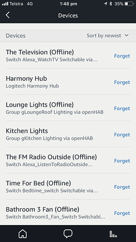

They show as offline in the Alexa app. When asking to “turn off the television”. She replies “hmm sorry the television is not responding”
I rebooted my Pi and they show as offline still but when commanding again it worked and then offline is not showing for that device on the Alexa app

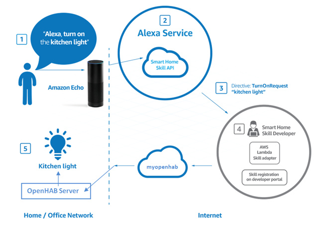

@Andrew_Pawelski See this overview:
details see here: Understand Smart Home Skills | Alexa Skills Kit
Maybe your ‘internet connection’ is a bit slow or flapping!

Did you also try (like in your example above: Turn on Kitchen Lights!), cause the device is NOT shown as “offline”? If so, is it running? And did you change any of your other item names or labels in OH2, and after this you also started the search in Alexa-APP again? What about clicking “Forget” all your OH2 devices and then “Search” them again?
