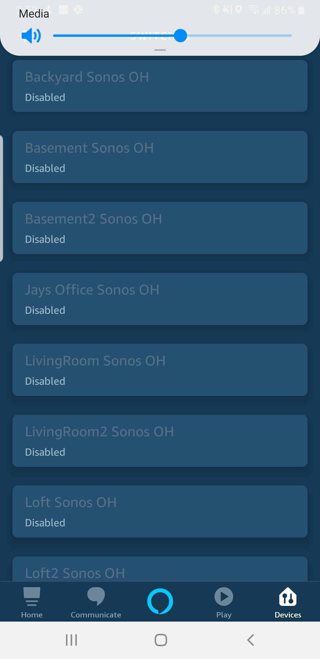

I have numerous Sonos devices connected via Alexa via OH HUE Emulation tied to Switches. I’m not using the Sonos Skill with Alexa so the actual Sonos devices are not listed as a device for me BUT
I ended up going into the Alexa Mobile App into devices and disabled ALL Sonos related devices that Alexa had linked up as a device from an OH perspective. It’s been 24 hours and NONE of my Sonos devices have fallen off OH since I did this. I have pushed rule policies at least 3 times and started/stopped OH also during this time period which sometimes starts to cause the issue with Sonos.
It’s my belief that Alexa/Amazon is scanning all devices for states and it causing the Sonos devices to fall off of OH. I’m not sure if this has anything to do with Sonos natively OR its tied to the HUE Emulation piece of it?
Can someone else having this Sonos issue please try what I did to help validate it?
