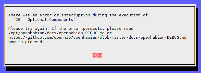

I’m trying to install InfluxDB + Grafana via the openhabian-config GUI, but everytime it ends up with the following error. Can anybody help, please?

Fetched 56.4 kB in 9s (6,153 B/s)
Reading package lists... Done
W: The repository 'https://repos.influxdata.com/raspbian stretch Release' does not have a Release file.
N: Data from such a repository can't be authenticated and is therefore potentially dangerous to use.
N: See apt-secure(8) manpage for repository creation and user configuration details.
E: Failed to fetch https://repos.influxdata.com/raspbian/dists/stretch/stable/binary-armhf/Packages  404  Not Found
E: Some index files failed to download. They have been ignored, or old ones used instead.
FAILED (update apt lists)
FAILED
2020-12-15_22:03:20_CET [openHABian] We hope you got what you came for! See you again soon ;)
