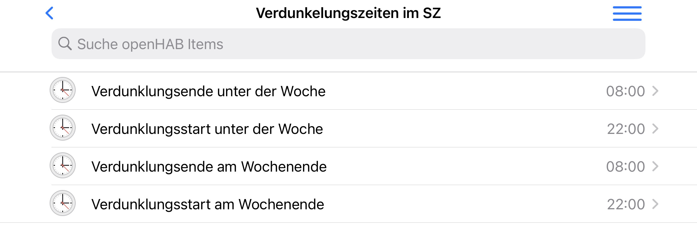

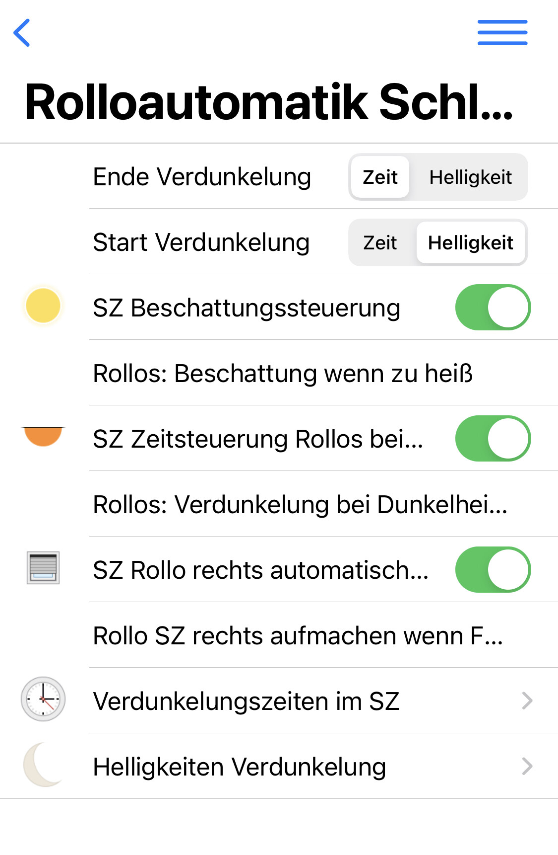

I will switch over from OH 2.5.11 to 3.0.0 but because many important systems in my house are fully automated via OH I fear if something wents wrong I have no time to fixe it cause my wife will kill me. :wink:
I’ve read the documentations and I think most of my rules will work without problems.
But I have four rules (three are quite similar) that ned to be changed because of joda/java time and I can’t find a solution in this forum yet. So I need your help.
Thanks a lot!

Because I sometimes have to change the time when the blinds open.
And I like to do this in the app.
