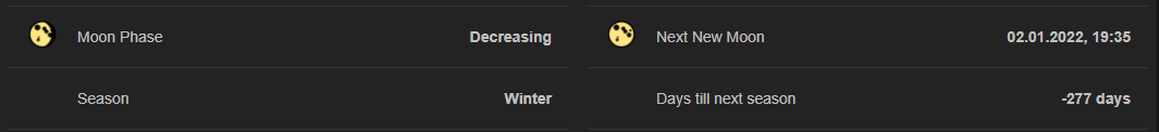

It seems it can’t handle day when season is changing (today) rest of the days are without any errors
it is doing this item
Number SeasonLeft "Days till next season [%.0f days]" <none> { channel = "astro:sun:home:season#timeLeft" }
