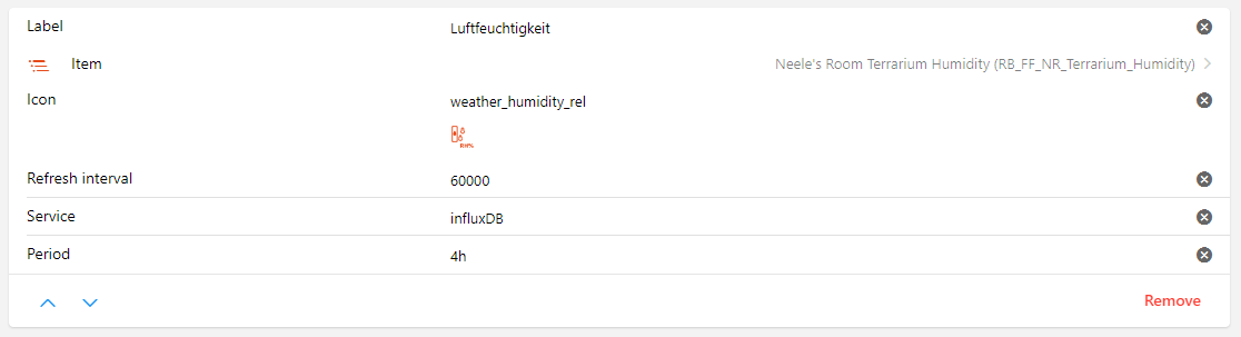

Question: I just created a smal sitemap for BasicUI, that shows if the heating in my daugthers terrarium is in and which temperature and humidity is there. Next step would be to create a smal chart that shows the humidity over the day.
With the sitemap builder this should be easy, i did not work.

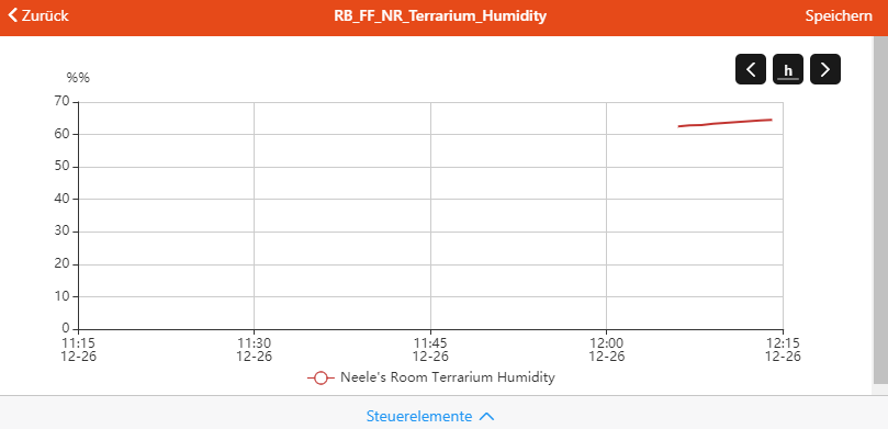

The values are resistet, what i can see from the analyse feature which is connected to my influxDB.
In the sitemap builder things are looking like that.
Unfortunately i did find no version3 documentation on sitemaps
The code checker said:
But the is no sitemapy displayed. if i remove the chart the sitemapy works fine. Maybe a disable option for entries would be nice, so we did not need to delete the entry for testing. Not everyone like to use the text editor.
The i looked into the OH3 log and found the following.

The only Integer/Bigdecimal i see is the refresh interval and if i remove it the sitemap is working well again.
Does anyone has the same problem oder is able to reproduce it?
