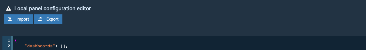

In OH2 if you select Radio Button next to Local Storage in the HabPanel SETTINGS Page. Then below the Local Storage item it says “Edit the local panel configuration (experts only)”. Click on that and you will be taken to a page that contains the HabPanel definitions. In the upper Left are the Export/Import Buttons. Just use them to create(OH2) and retrieve(OH3) the HabPanel.
