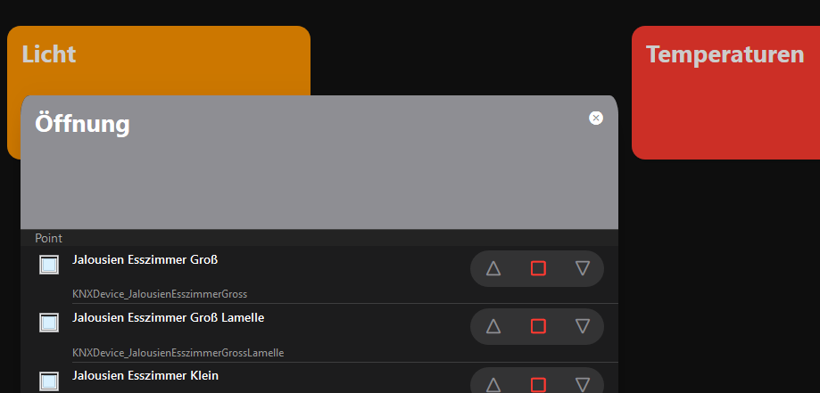

But when I then did the same thing in the DiningRoom
Image attached NR 4
Are suddenly things also migrated, even from the living room to the dining room. WHY ???
Image attached NR 5

I used a Point instead of Equipment… looks better now
I’m having the same issue, but Point did not solve the issue. I can assign the channels as Points in the model, but then it doesn’t show up in the UI ?
