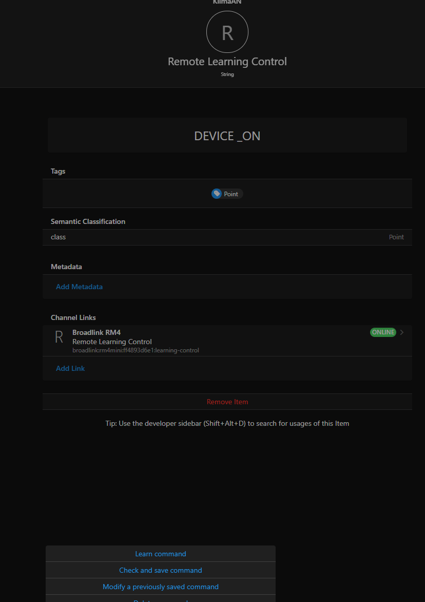

What’s my problem:
I have created to items als command. Lets say there name is KlimaAN and KlimaAUS
Then I created also to items under the learing section. Same name.
Now I open open the learning section the item KlimaAN,
Press the button to lean. the LED wake up.
Use my IR remote control send the command to the RM4mini.
The LED goes off.
I use the botton to save, and the NULL in the item change to "
When I do the same proces with learn and store, with the other item “KlimaAUS”,
the item becomes the same information with “Device_ON”
See here:
What I’m doing wrong here?
From prinipal I need two comands under the learing section and under the comands section, right?
BR
Jochen
This is where you go wrong. Read the instructions on the market place post. IR/RF Commands are not openhab command channels. They are strings passed to a command channel. To create a IR/RF command, set the name of the command in the thing property “Name of IR/RF command to learn”. Then go to the channel “Remote learning control” and make sure an item is associated with the channel. Next, click on the item, and click on the “NULL” value box. Choose “learn command” and point your IR device to the broadlink box. Next, choose “check and save control” and repeat the IR command.
The IR command is now saved under the name of “Name of IR/RF command to learn” property you defined earlier.
Create 1 item under the Command channel. Click on the command item, click on the “NULL” value, a pop-up menu should now appear with your new command to use.

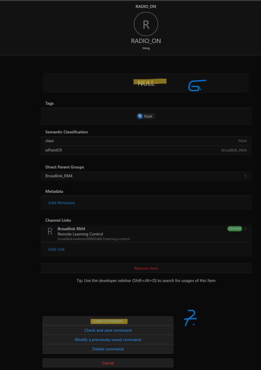

  1. Then you open the new named command under the lean section, and press the section in the upper area which is current called “NULL”. It opens a section.
  2. Choose the section and click for learn command.
    → the RM4 mini LED goes with and the is now ready to learn the command from your IR sender.
    → Then you use your IR sender and send to the RM4 mini the command, by pressing the key on your sender. Takes 1-2 sec.
    The LED goes off after that on the RM4 mini.
    You close the section of the channel and can reopen it.
  1. Then you can click on the section of the learned command again, and the same button list comes up, where you can save the command.
