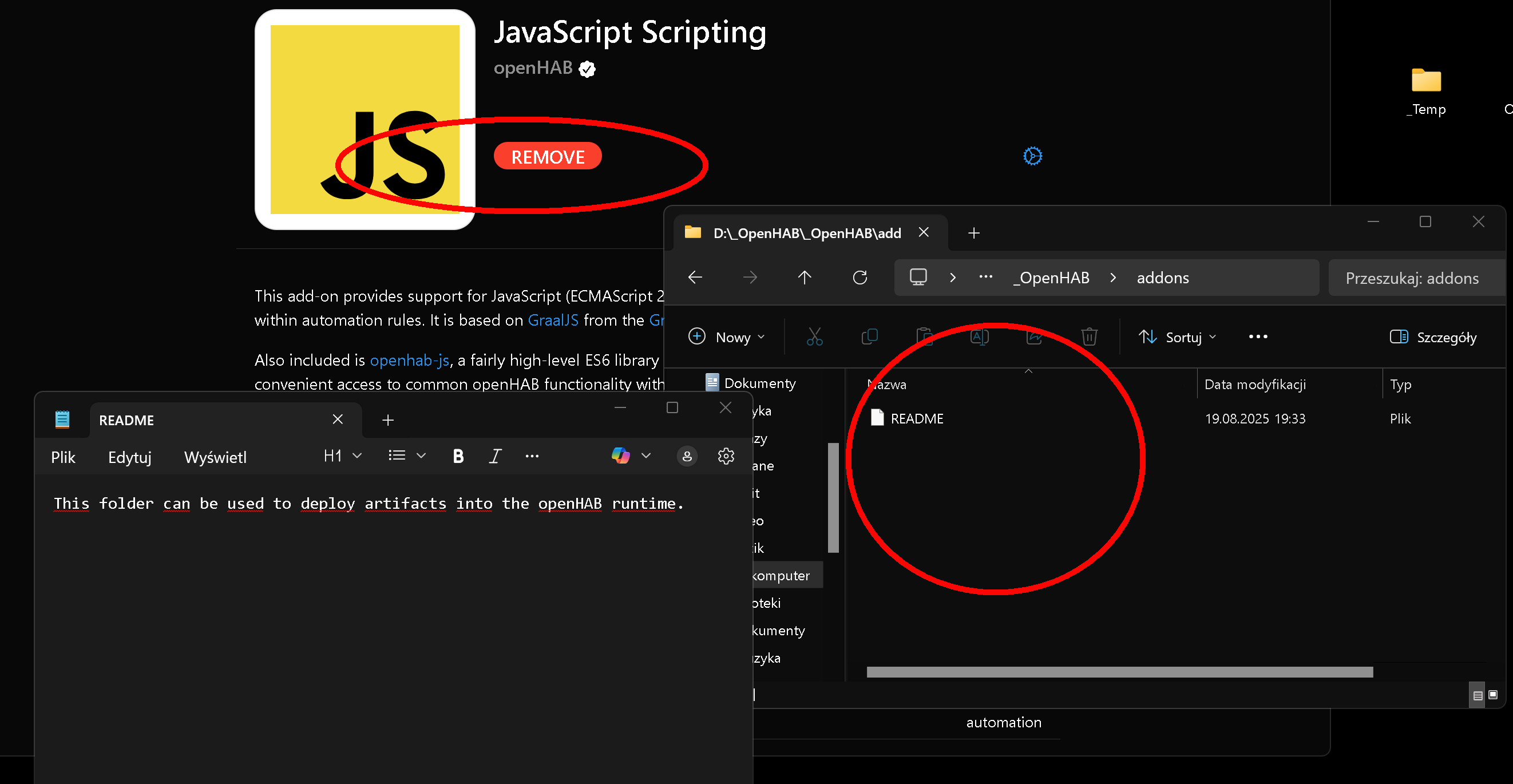

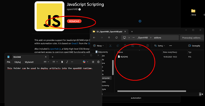

Double check that you have the JS Scripting add-on installed and you do not have anything in the addons folder.
double checked:
JS - installed, but nothing in addons folder….

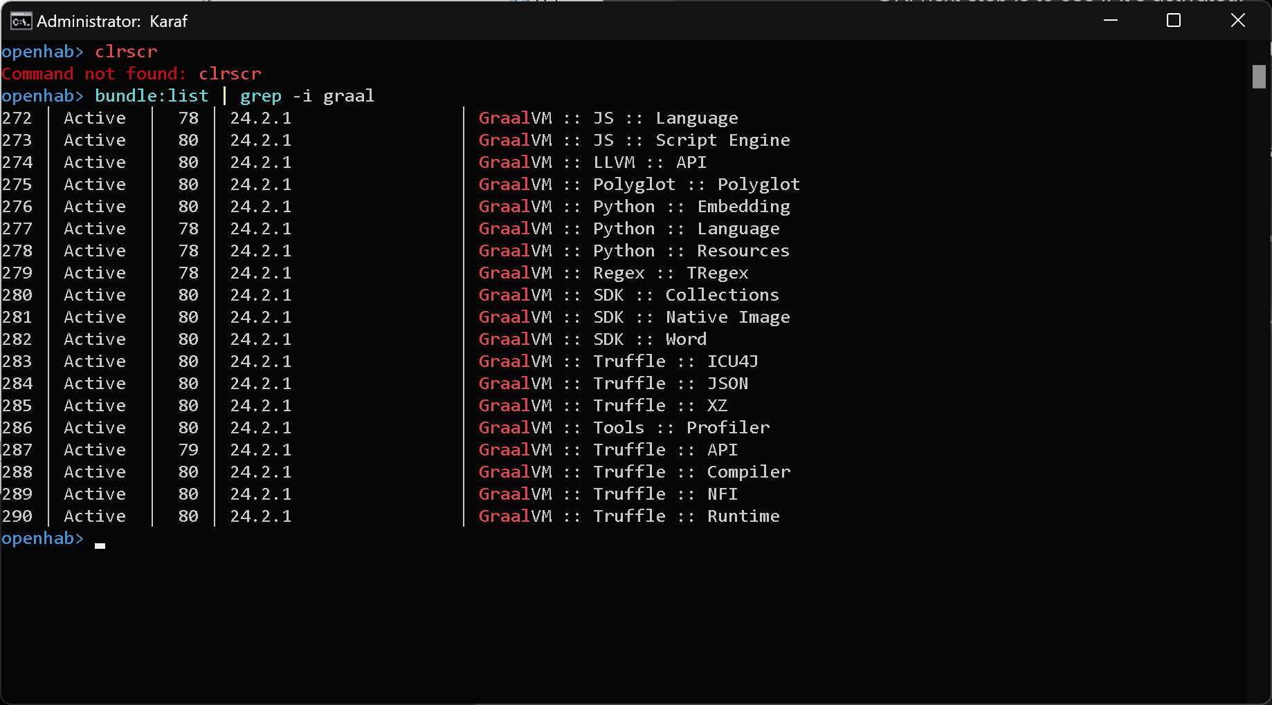

Next run bundle:list | grep -i graal. The results should look something like this:
openhab> bundle:list | grep -i graal

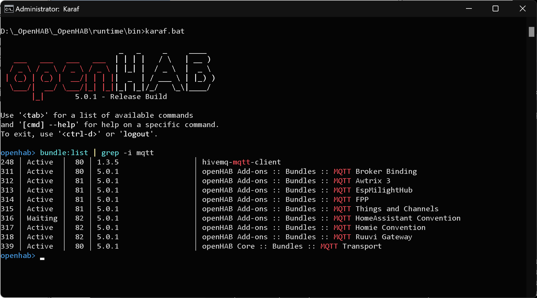

Finally, bundle:list | grep -i mqtt which should look something like:
openhab> bundle:list | grep -i mqtt
252 │ Active │  80 │ 1.3.9                 │ hivemq-mqtt-client
326 │ Active │  80 │ 5.1.0.M1              │ openHAB Add-ons :: Bundles :: MQTT Broker Binding
327 │ Active │  81 │ 5.1.0.M1              │ openHAB Add-ons :: Bundles :: MQTT Awtrix 3
328 │ Active │  81 │ 5.1.0.M1              │ openHAB Add-ons :: Bundles :: MQTT EspMilightHub
329 │ Active │  81 │ 5.1.0.M1              │ openHAB Add-ons :: Bundles :: MQTT FPP
330 │ Active │  81 │ 5.1.0.M1              │ openHAB Add-ons :: Bundles :: MQTT Things and Channels
331 │ Active │  82 │ 5.1.0.M1              │ openHAB Add-ons :: Bundles :: MQTT HomeAssistant Convention
332 │ Active │  82 │ 5.1.0.M1              │ openHAB Add-ons :: Bundles :: MQTT Homie Convention
333 │ Active │  82 │ 5.1.0.M1              │ openHAB Add-ons :: Bundles :: MQTT Ruuvi Gateway
363 │ Active │  80 │ 5.1.0.M1              │ openHAB Core :: Bundles :: MQTT Transport
Again, the second column should all read “Active” and the fourth column for all by the hive-mqt-client should match the version of OH you are running.
here you are:
And the rest?
sorry missed by me, it’s here:
I need the graal one too
sorry, to fast…

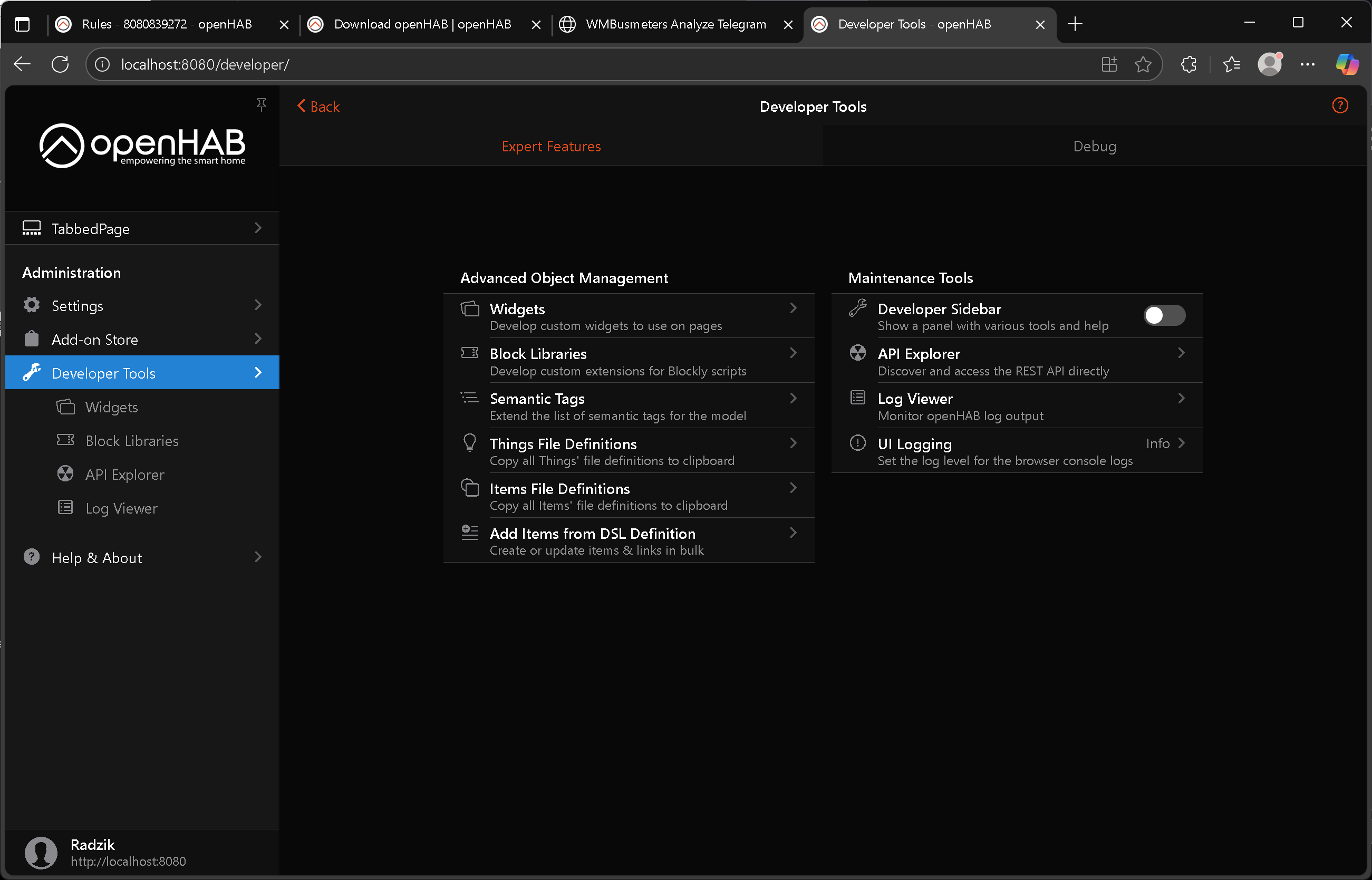

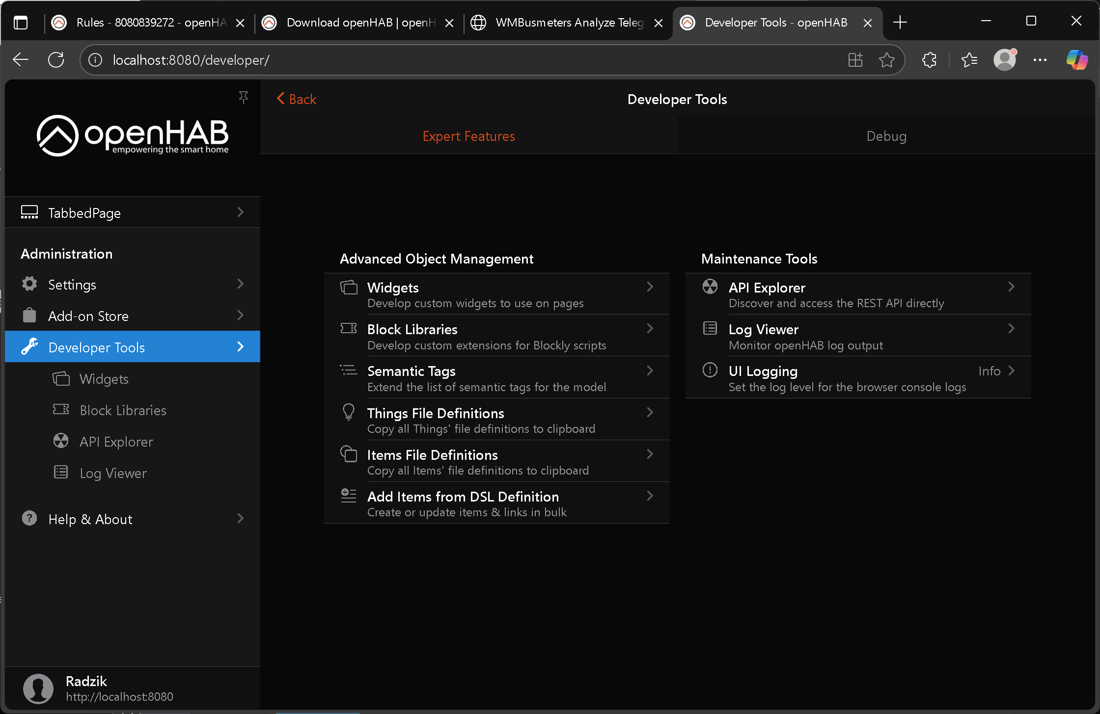

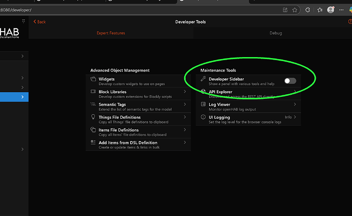

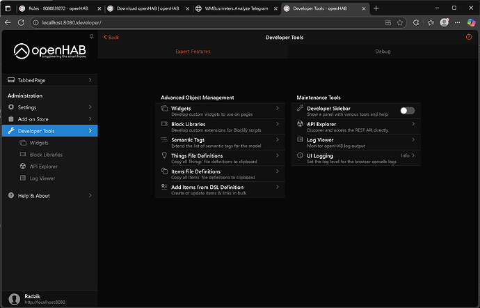

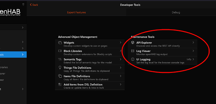

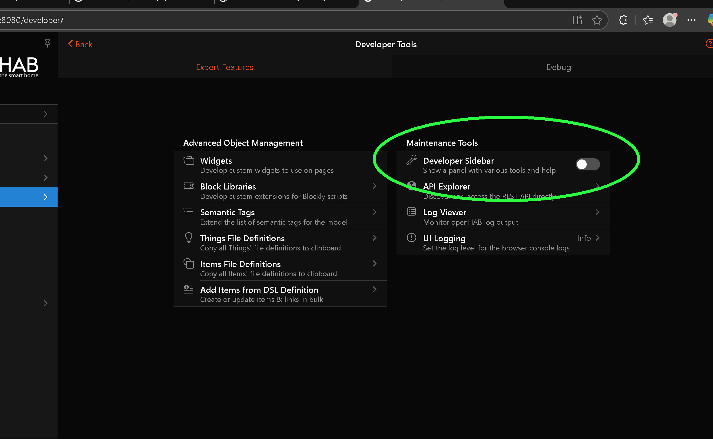

wait, wait,…I tried to find a script with identifier which report a error….and the developer side bar is not available(!) but only in FireFox…Oh my God, what’s going on here?
but developer side baqr I see in the Edge…
Jesus Christ! This is not a browser problem but problem with the size of any browser window(!)
When the window of browser is smaller then Developer Side Bar is hidden(!)
smaller window of FireFox:
and a little bit bigger window(!)
grrrrrrr

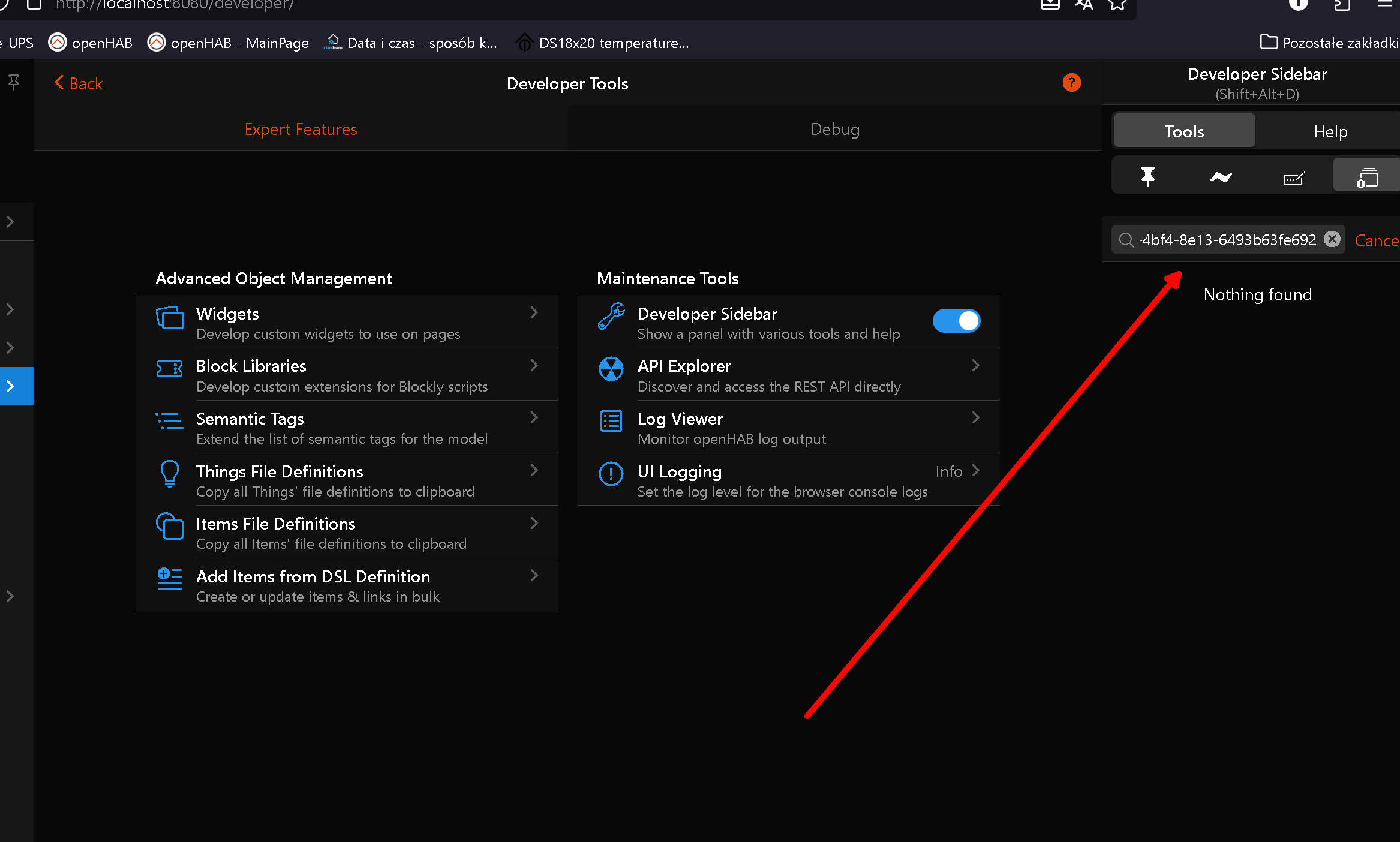

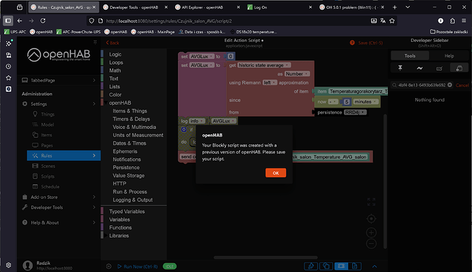

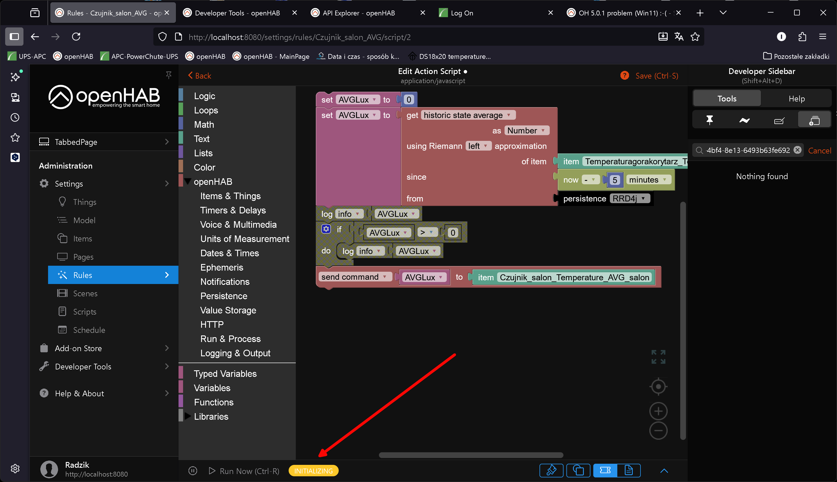

how to find the rule that is genereting the error if error in log is like this:
[ERROR]	 [ipt.internal.ScriptEngineManagerImpl] - 	ScriptEngine for language 'application/javascript' could not be found for identifier: 5393d810-ba10-4bf4-8e13-6493b63fe692
but through the developer bar search window is nothing to find when I put the identifier eg. this:

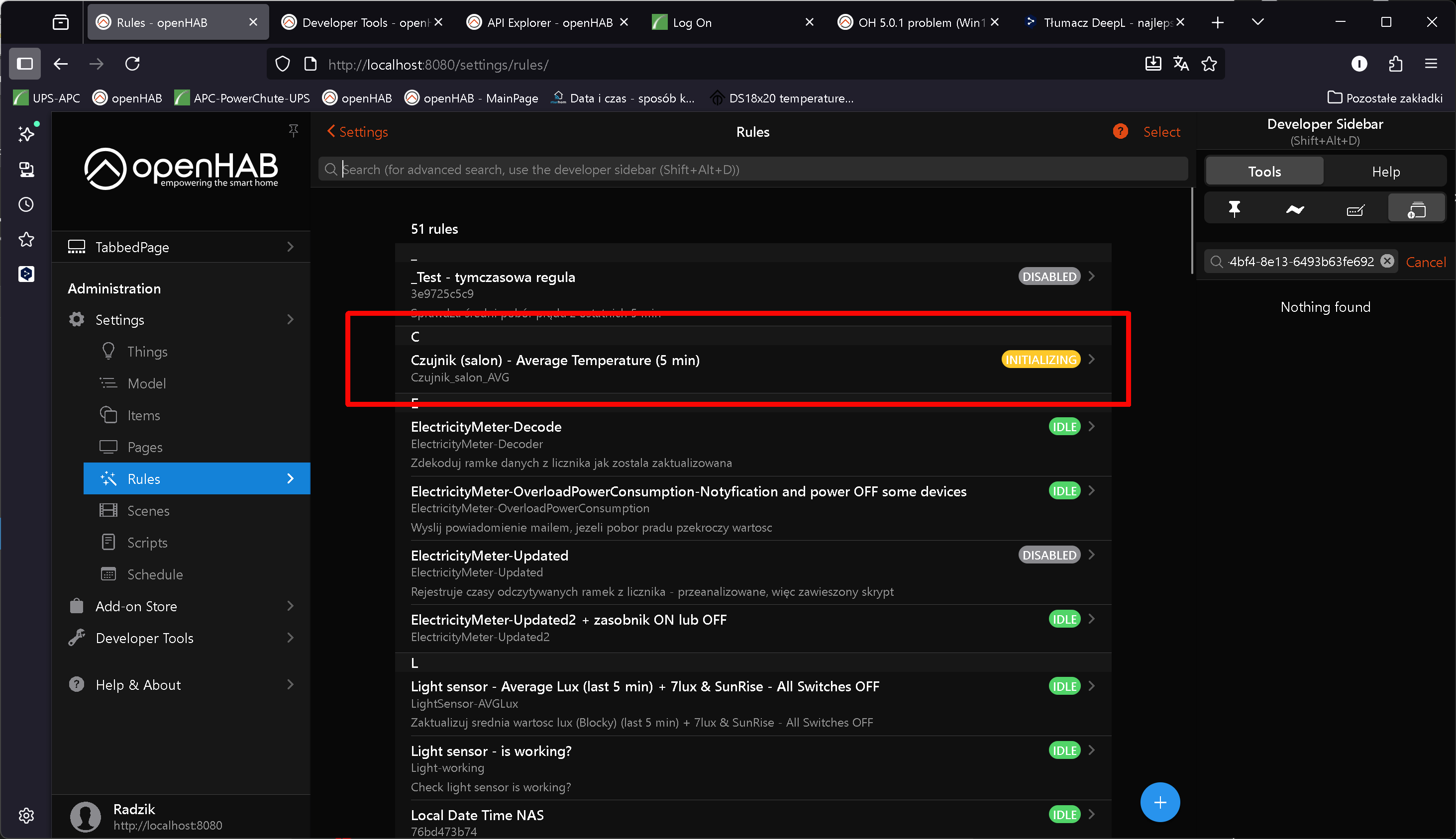

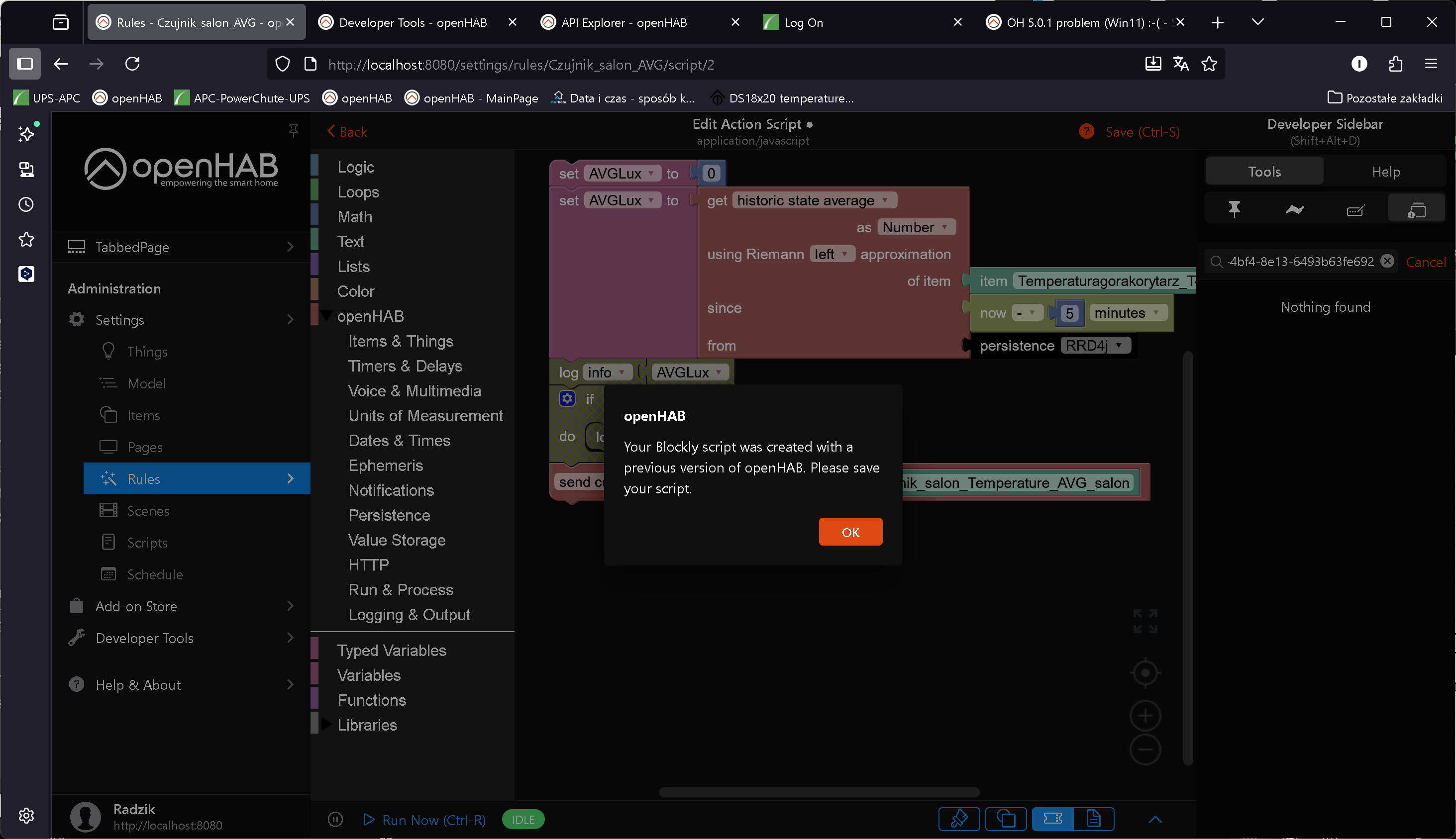

but something interesting I see when I tried to open some rule - “openHAB
Your Blockly script was created with a previous version of openHAB. Please save your script.”
maybe shoud I re-open and re-save all rules?

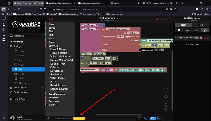

I guess that’s not the end of the problems…
I opened the script that shows this notification (I clicked OK), I clicked “Save” and… for 5 minutes now I’ve been seeing “INITIALIZING.”
I had to exit the script without saving… and the script is still “hanging” as “INITIALIZING.”
I don’t know what’s going on here, whether it’s due to some bugs in version 5.0.1 or some other reason.
