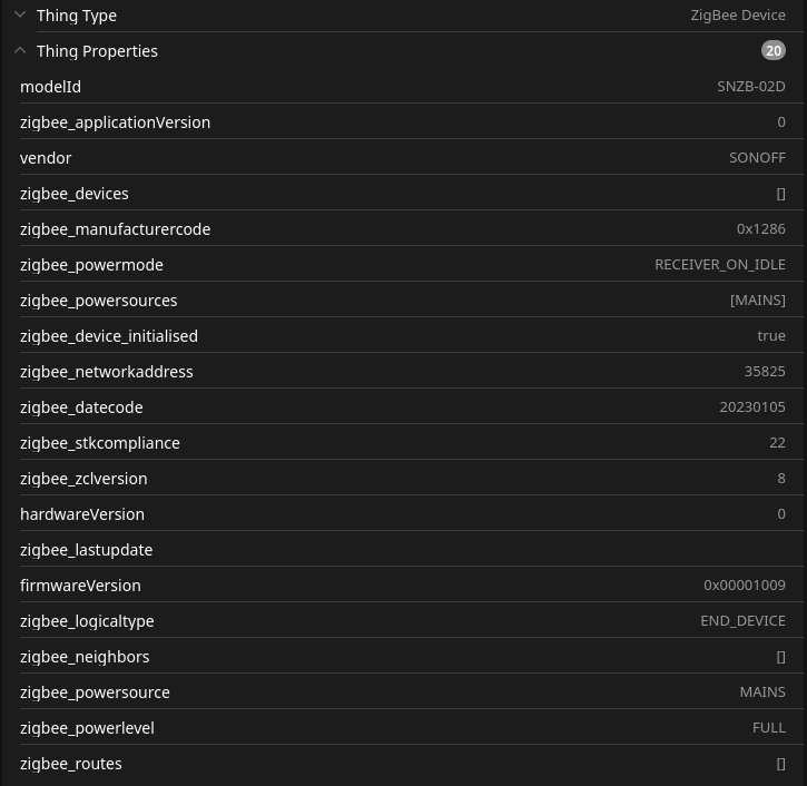

The first thing that catches my eye is the device you are showing in the screenshot does not appear to have been discovered correctly.
the SNZB-02 is a battery-operated device and it currently shows as being mains powered that is not correct. I would try removing the device and then reset it and discover it again be patient during the pairing process and allow it plenty of time to complete. If the device does not discover correctly, it likely will not reliably report.
I would start there and make sure all your devices are discovered with correct power source.

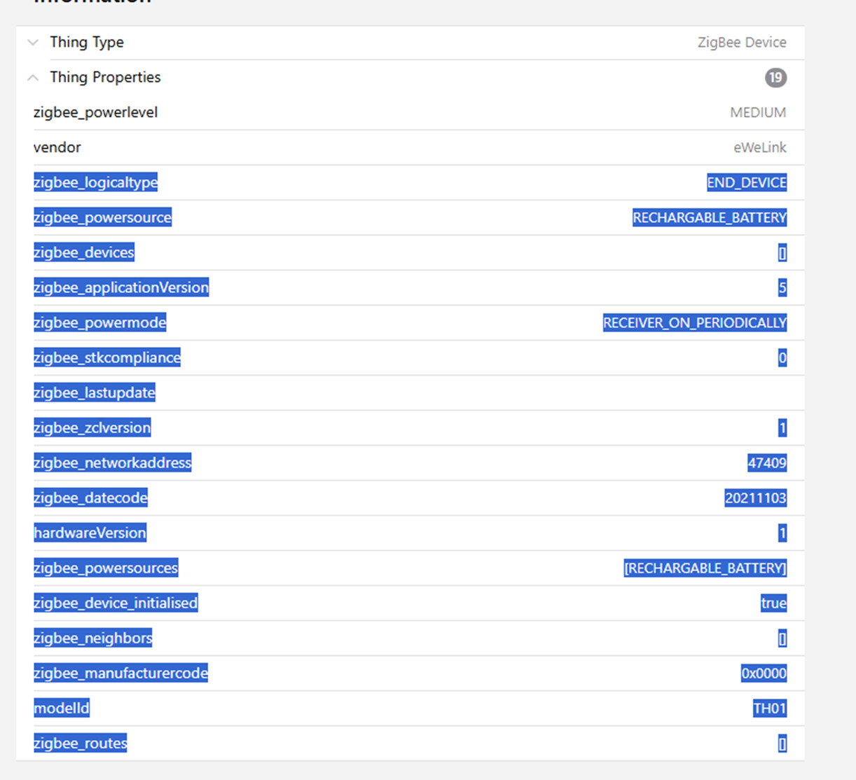

Although I think its a good starting point, I don’t know what the “correct” power source would look like. I’ve checked my other sensors and they all report the same type. Therefore I wonder if they could even have a different one.

This is what one of my Sonoff SNZB-02 temp sensors discovered as and displays it is a real one came in the orange box not a knock off. I allowed discovery via UI.

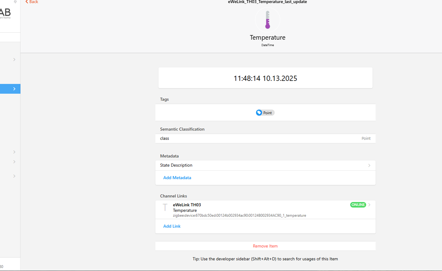

No, you just need to add a duplicate item to the channel you want to get last changed time on not a new time thing.
this is the code for a last updated time item I created for it.
label: Temperature
type: DateTime
category: Temperature
groupNames: []
tags:
  - Point

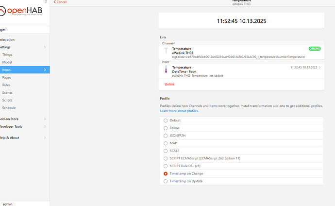

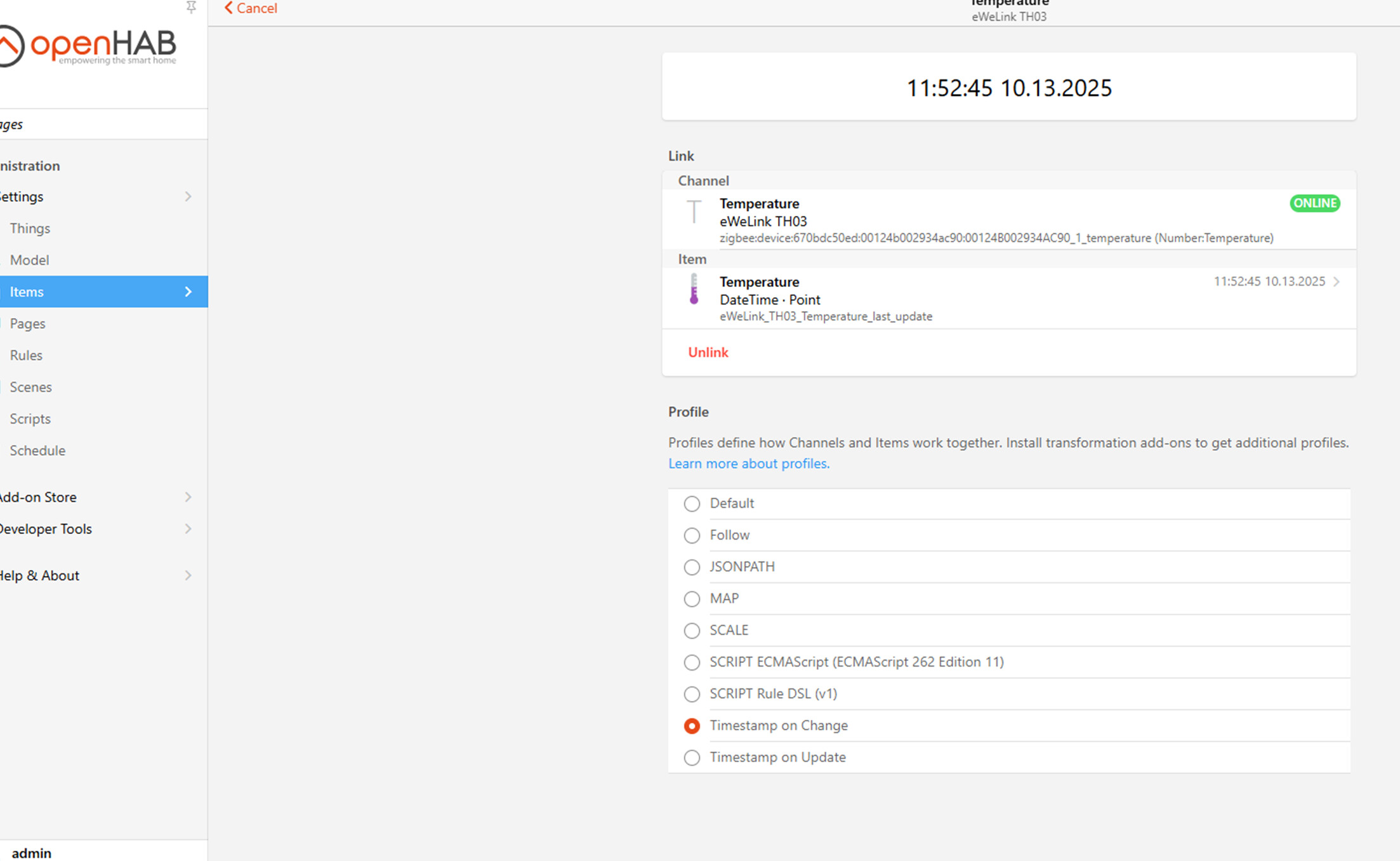

when I linked the duplicate item for the temp
I set it up like this and I formatted the time to how I wanted it to display in metadata pattern with this
 %1$tH:%1$tM:%1$tS %1$tm.%1$td.%1$tY
you may want something different

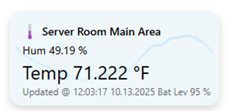

I modified a widget to provide the update so I see this
Hope this answers your questions
