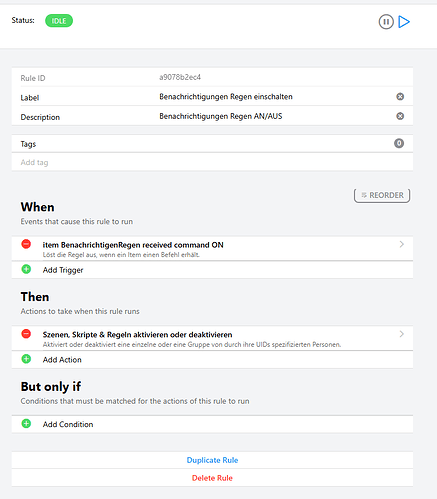

@rlkoshak: you ask me to make a new entry. Here we are. Who could have a look on that?
First it’s important to get the terminology correct. You are not enabling or disabling the whole rule. You are only disabling or enabling a single action of the rule.
Secondly, the action you are using will enable or disable another rule or rules. In this your action will enable the rules with the UIDs of ce178d9d35 and d5e8ec7511.
When this rule runs, it should enable those two other rules. There won’t be any indication of enabled or disabled in this rule, because that’s not changing for this rule. However, you should see that those two other rules will have a status of “IDLE” with the green badge showing that they are enabled.
If you have another rule that disables instead of enables, the other rules that are disabled should show a status of “DISABLED” with a gray badge. But this rule’s status will not change.

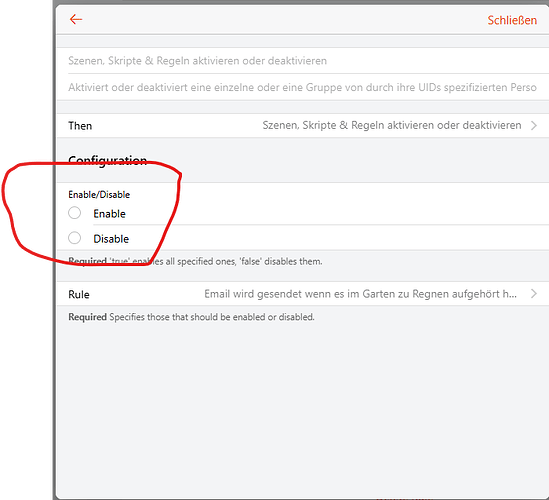

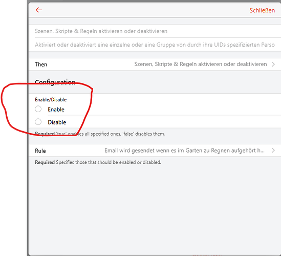

@rlkoshak , it is not about the the feature or the function is not working. All fine.
It is only, the the UI is opend, like here
the value e.g. “true” for enable is not set with a Dot, etc. as active.
So would expect, that when I open in the UI this rules, it shows me, it is enabled, or disabled, with the gray badge. So this rule is doing an enable a rule, and an other rule is disable them.
So like a switch. The rule is a switch with only for enable, and a other rule is for disable.
So it should be marked, what the rules is doing.
OK, now I understand.
That’s a bug. Please file an issue on openhab-webuis. I’m going to bet there’s a simple typo somewhere in the UI.

Fixed in 5.1.2 Thanks for this.
