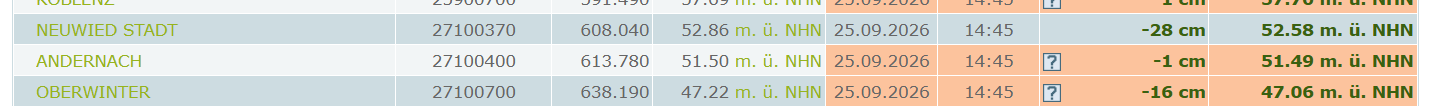

In theory this can happen if level is below 0. Checking this via Aktuelle Wasserstände an den Bundeswasserstraßen | PEGELONLINE it seems possible! Can you check if the water level of your configured station is currently below / near zero 0?
Definitely it is below zero, currently at -0,22m.
And that is pretty ok since a relative level indication, not absolute related to the mean sea level.
