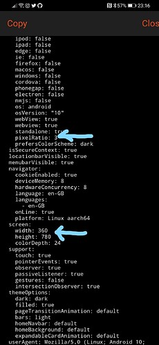

In fact if you go to the About page while logged in, then Technical Information > Details, you will see the dimensions of your screen as seen by the UI:
So in this case while the actual screen resolution is 1080x2340, the pixel ratio is 3 so the “perceived” screen size is a third of that in every dimension, so 360x780. Hope it makes sense.
