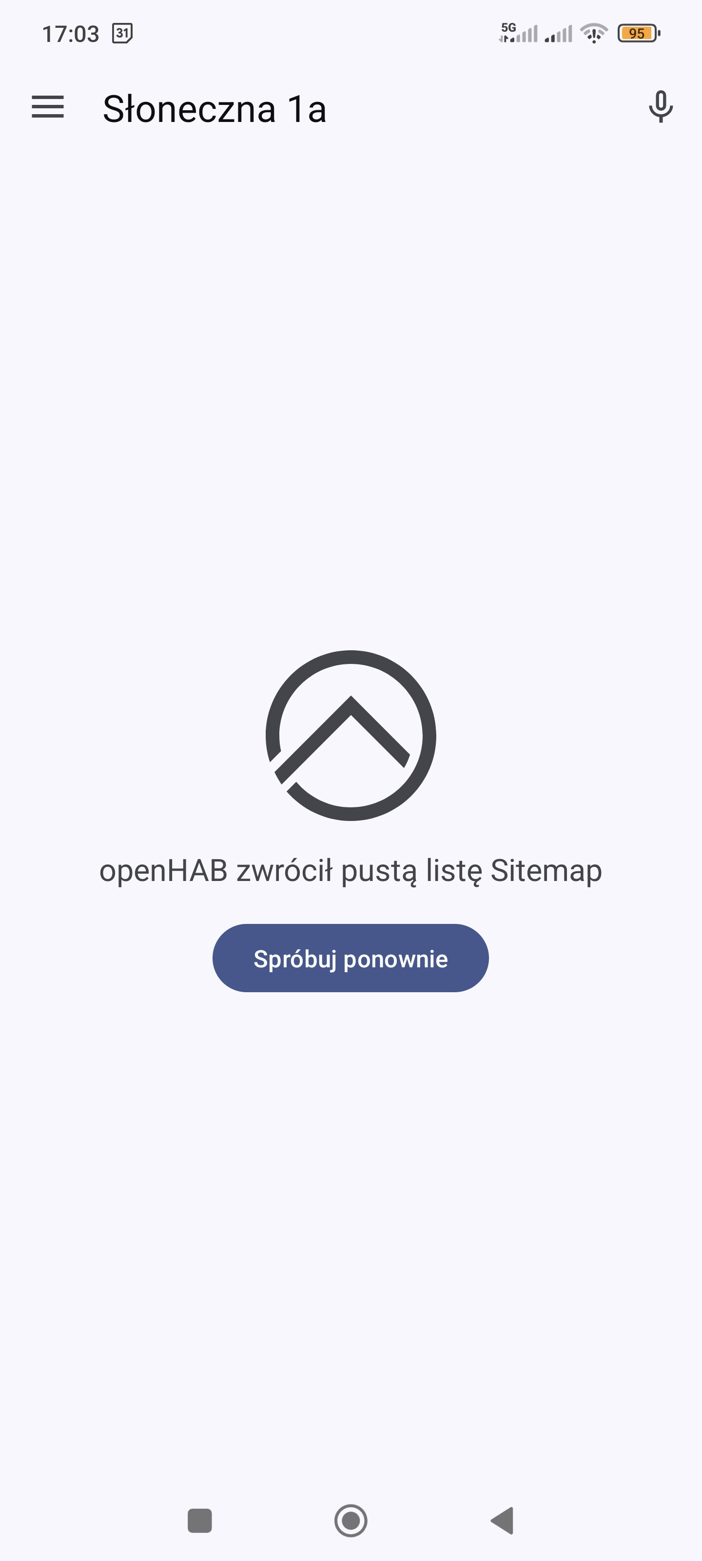

After configuring the connection, I see a blank page as shown in the image:
(in translation - “OH return empty list of Sitemap”)

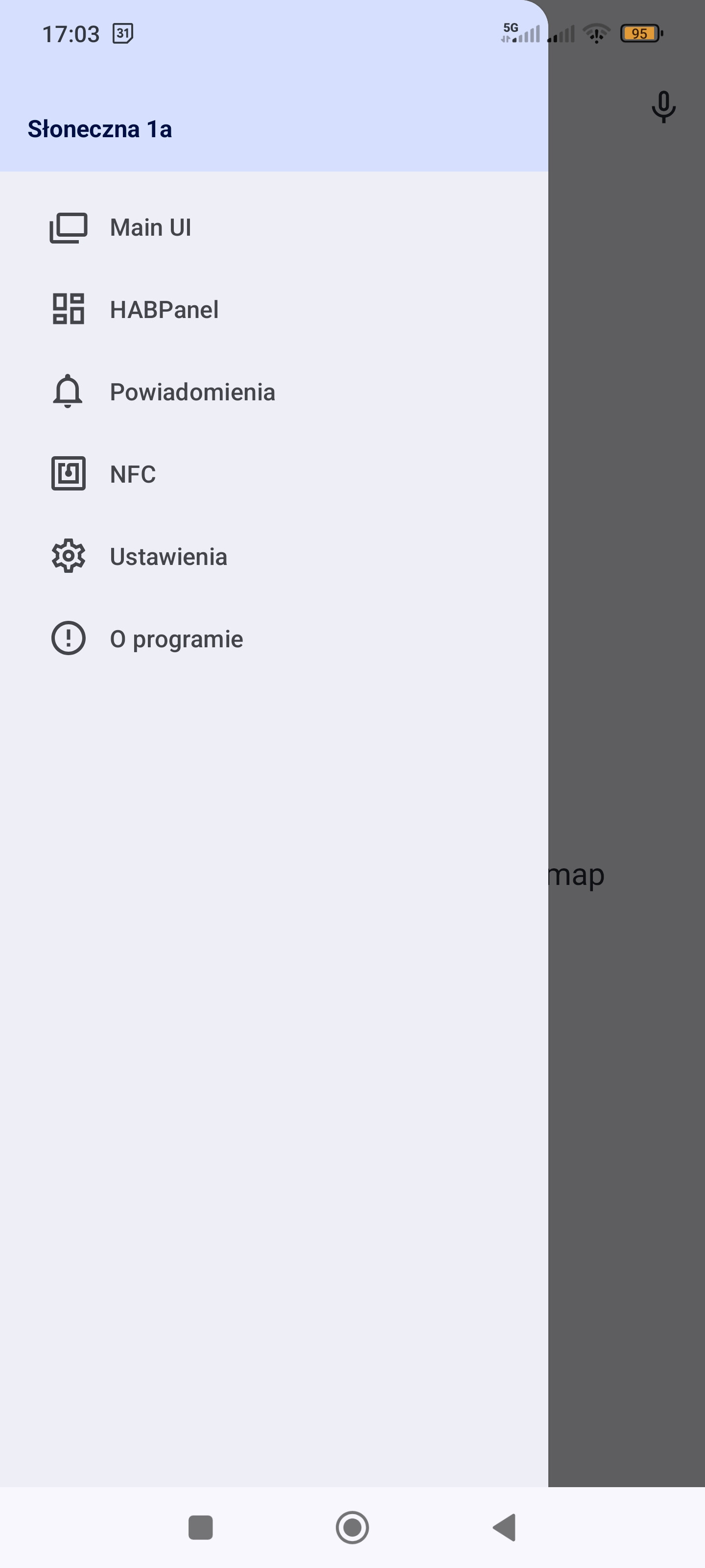

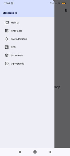

but on the left side of the menu, I see the following options:
After clicking “Main UI,” I see my OH panel, but I would like to see my panel immediately after running the mobile app.

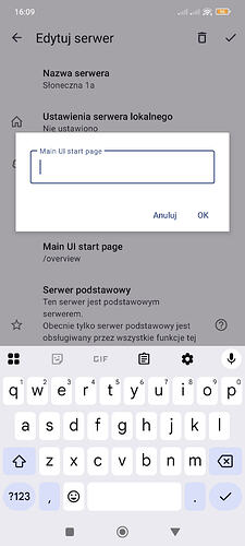

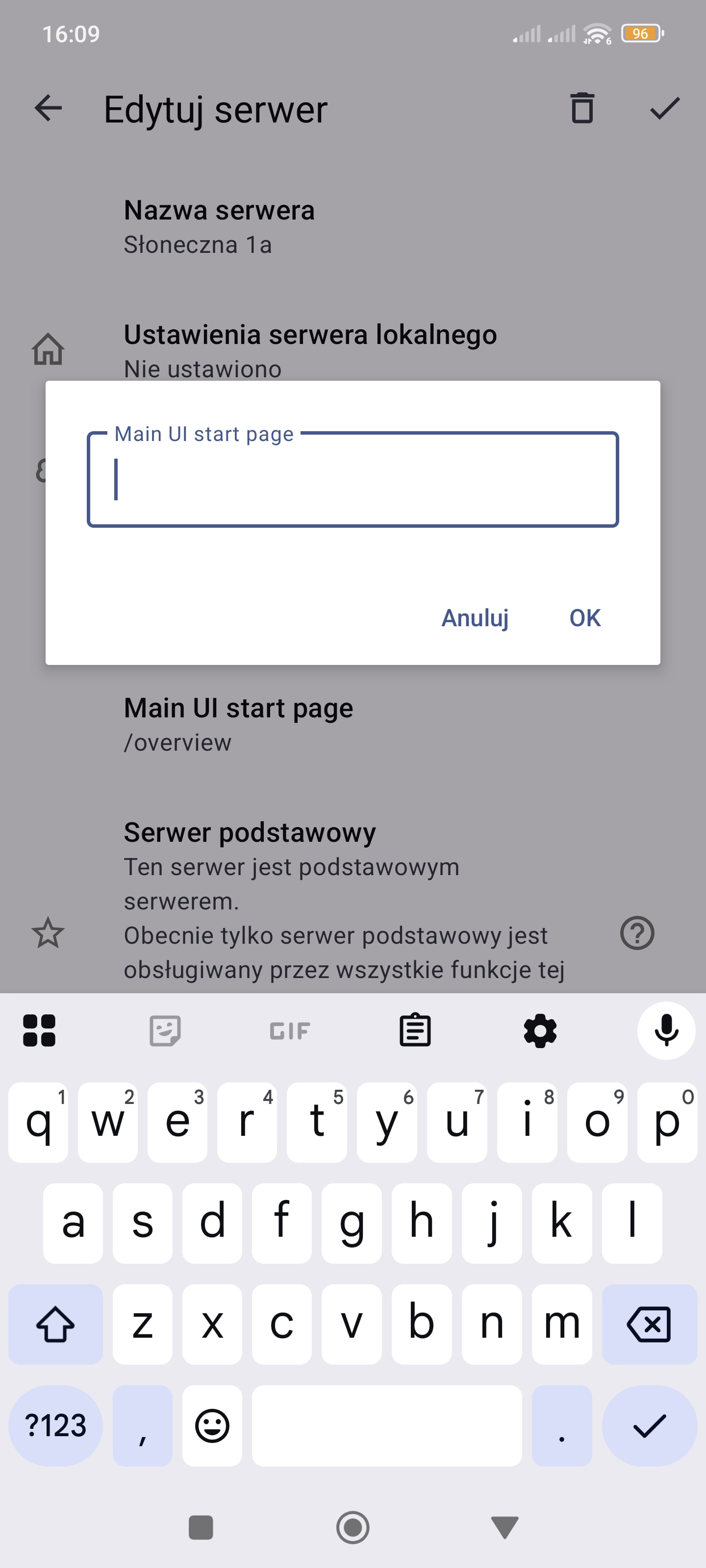

In the settings, I am trying to set “Main UI start page”, but I don’t know what should be entered there, and the documentation is silent on this subject
I mean about this field in configuration:
  • Should there be a path, e.g., “/overview”?
  • Or maybe the name (and which one) of the page, e.g., “Strona Główna” or “Layout” or “Overview”?
  • Or maybe something else?

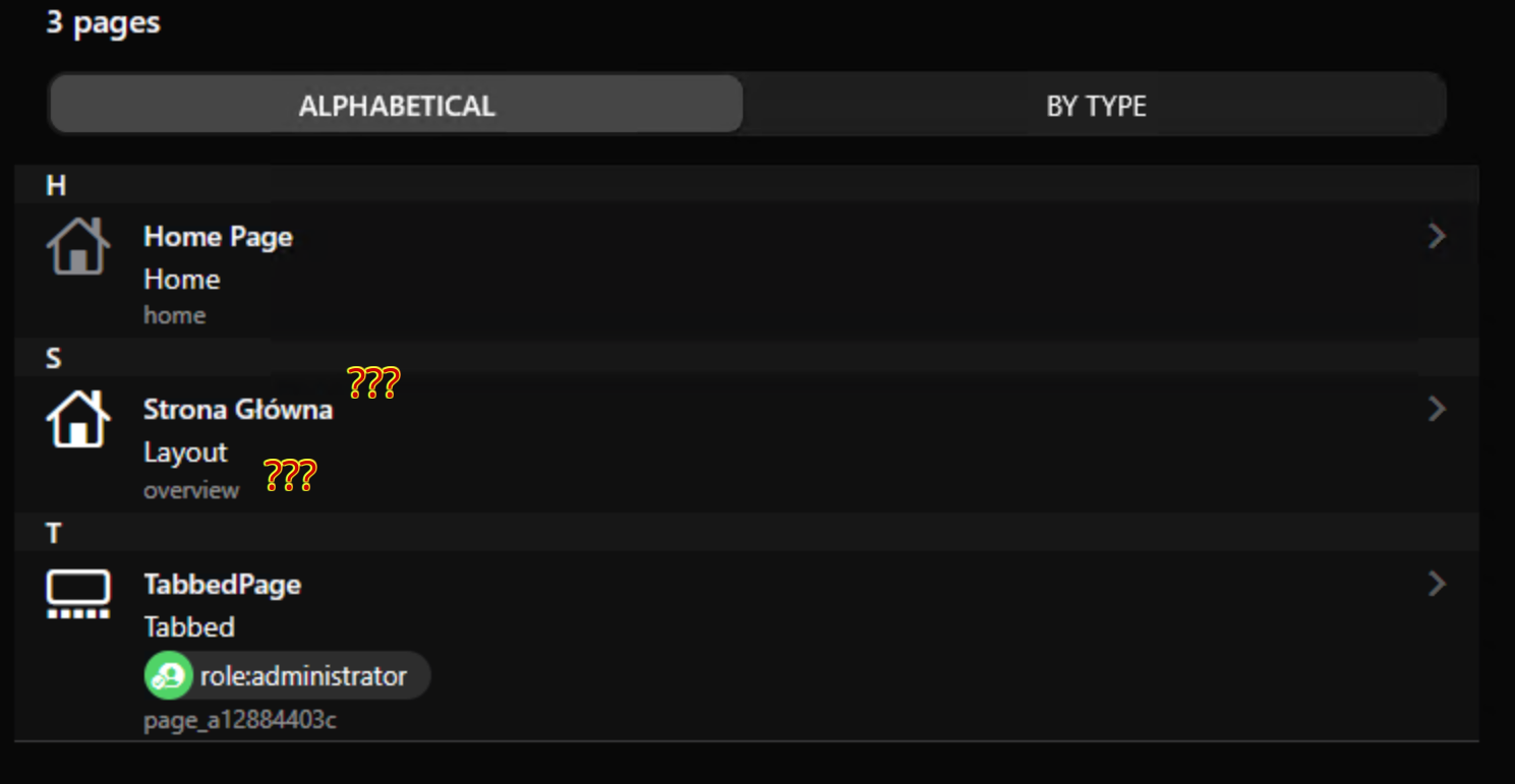

My defined pages are:
I would be grateful for your help.
If you want MainUI at startup, you need to change the ‘Start page’ option under ‘Display’ settings (2 settings above the color scheme option).
Great it works. Thank you!
But what for is the option “Main UI start page” mentioned in my post?
It’s a relative path to select the page inside MainUI to be used on startup. Basically the part of the page URL after the server name.
Thank you for the explanation, I can’t quite imagine how to use this, but thank you very much for the information.
