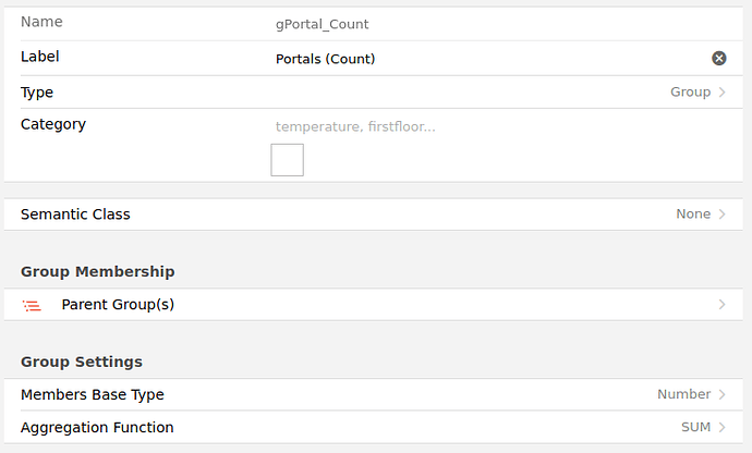

This is a fairly common use case, however, and there is a typical solution that you may find preferable. OH has a built-in way of handling this easily. Like you I have a group that tells me if any door is open (gPortals) by using an aggregation function. I have a second group that contains all the same door contacts (gPortal_Count), but I use a different aggregation function:
By treating the member base type as a Number the aggregation function gets 0 if a door is closed and 1 if a door is open, so the sum of those numerical states is the count of how many doors are open.
With this setup you don’t need the repeater for your label, it would just looks like this:
- component: Label
    text: "=(items['gAllDoors'].state === 'CLOSED') ? 'All doors closed' :  items[`gAllDoors_Count`].state + '/20 doors open'"
