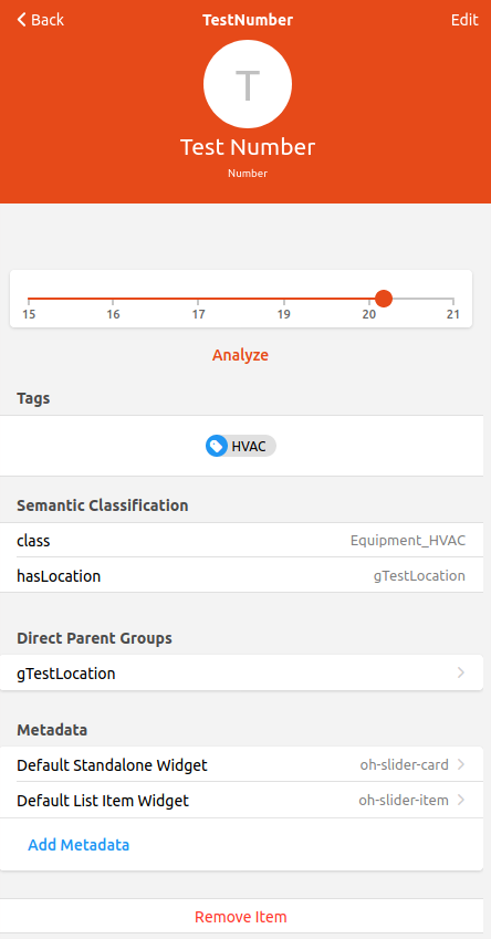

The slider widget is missing `18` on the scale, which means the 'ball' is not in the correct position either...
![image](https://user-images.githubusercontent.com/62958838/103587276-caf9b200-4ede-11eb-94bd-2ce0dde0940d.png)
## Expected behavior
Describe what you expected to happen or how it should look/behave.
I would expect to see the numbers 15, 16, 17, 18, 19, 20 and 21 equispaced, with the 'ball' of the slider perfectly atop one of the integers.

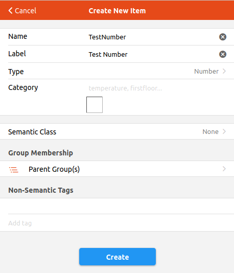

1. Create a number Item as follows:
![image](https://user-images.githubusercontent.com/62958838/103587019-3c853080-4ede-11eb-85ca-5b1fdc3de241.png)

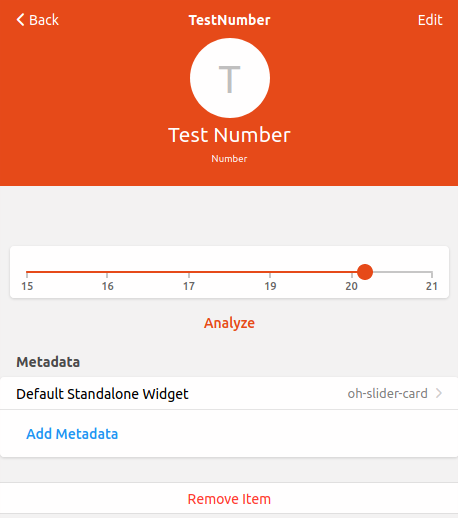

2. Define a _Default Standalone Widget_ and add metadata as follows, and Save:
```yaml
value: oh-slider-card
scale: true
step: 1
min: 15
max: 21
3. Slider widget ends up looking like this, with `18` missing from the scale, and the 'ball' of the slider not sitting atop exact integers.
![image](https://user-images.githubusercontent.com/62958838/103587216-aa315c80-4ede-11eb-9326-9c3b72b4670e.png)

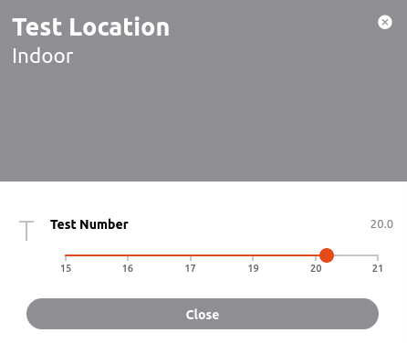

This configuration:
![image](https://user-images.githubusercontent.com/62958838/103587687-b0740880-4edf-11eb-9368-7ad66e5fe97f.png)
Results in:
![image](https://user-images.githubusercontent.com/62958838/103587727-ca155000-4edf-11eb-9961-f112620870a5.png)
when clicking on the _Test Location_ from the _Locations_ tab.
