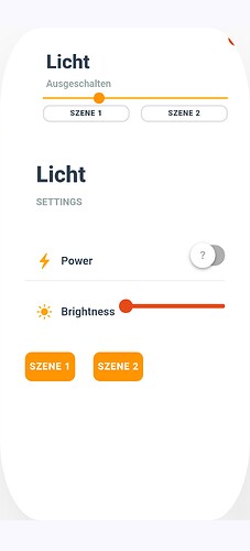

I’m creating a custom widget with an oh-slider component that displays correctly but cannot be moved/interacted with. The slider appears with the correct styling and current value, but dragging the knob or clicking on the track does nothing.
Widget Configuration:
- component: oh-slider
    item: =props.dimmer_item
    min: 0
    max: 100
    style:
      --f7-range-bar-size: 6px
      --f7-range-bar-border-radius: 3px
      --f7-range-knob-size: 24px
      --f7-range-active-color: orange
      width: 150px
What I’ve tried:
  1. Removing fixed width from the slider
  2. Wrapping in a container div
  3. Adding step, scale, and other properties
  4. Different CSS variable approaches
  5. Using --f7-range-size instead of width
  6. Verifying the item is writable (it is - other controls work on the same item)
Context:
· The slider is inside an expandable card widget
· Other interactive elements (buttons, toggle) in the same widget work fine
· The item updates correctly when changed from other controls
· The slider shows the current value correctly
· Only the interactivity is missing

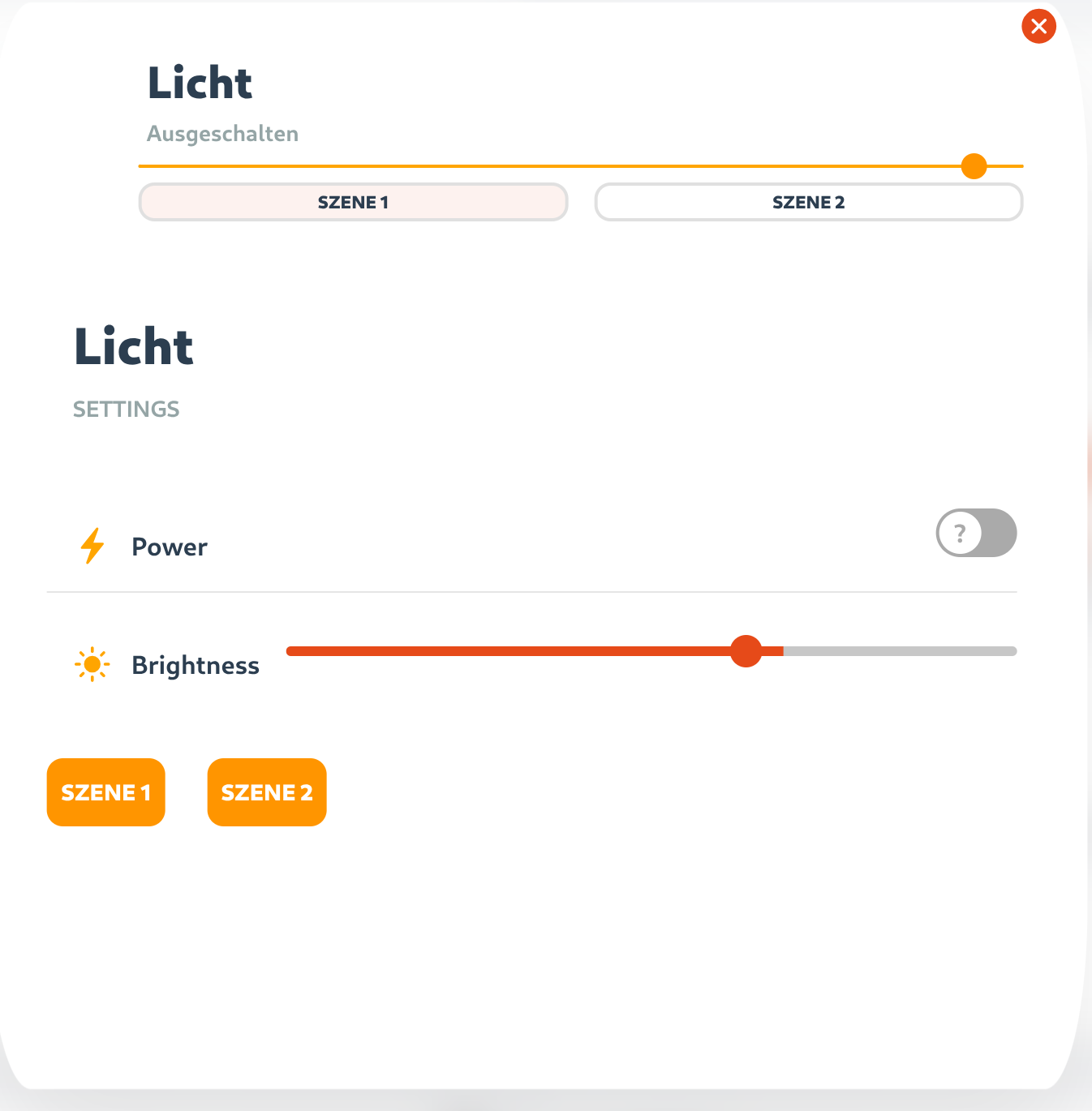

The widget code appears functional and the slider works when I do quick test on my system. What version of OH are you using (I’m using a 5.2 snapshot from a few weeks back)?
Mobile screen
Desktop

I still can’t replicate the issue. Both sliders are fully interactive when I test the posted widget code. So, I wonder if there is something else going on.
Are you seeing this problem in the widget editor or only when you place the widget on a page?
Neither nor…
Hmmm…very strange.
What browser are you using? I’ve tested it on Firefox and Chrome and it works in both.
There’s very little way for the component itself to loose its interactivity. The most likely situation is that, for some reason when it is rendered in your system, there is some other transparent element on top of it so you can’t click on it. Try right clicking on the slider and selecting “inspect” from the context menu. If you don’t see some part of this html highlighted:
