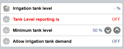

To demonstrate what I wanted to achieve..
Glad you got it working and I’m sorry you had such a challenge getting it to work. I’ve become a complete Expire binding convert largely because working with Timers can be so error prone and the errors seen can be very challenging to figure out what went wrong.
No need to be sorry… :slight_smile:
It has nothing to do with you…
As I said, most of these cases I read on the forum did not end up with a resolution… and the ongoing issue of cryptic errors the average, let alone newbie, cannot resolve.
At least , we’ve got something working now… :slight_smile:
