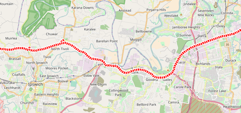

Well, it is working… get OwnTracks GPS data via iPhone → hole in firewall for port 1883; and an see the track in OwnTracks web… but have not done anything further with OH.
