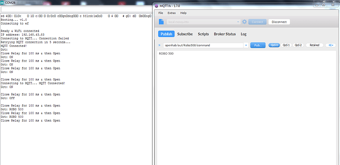

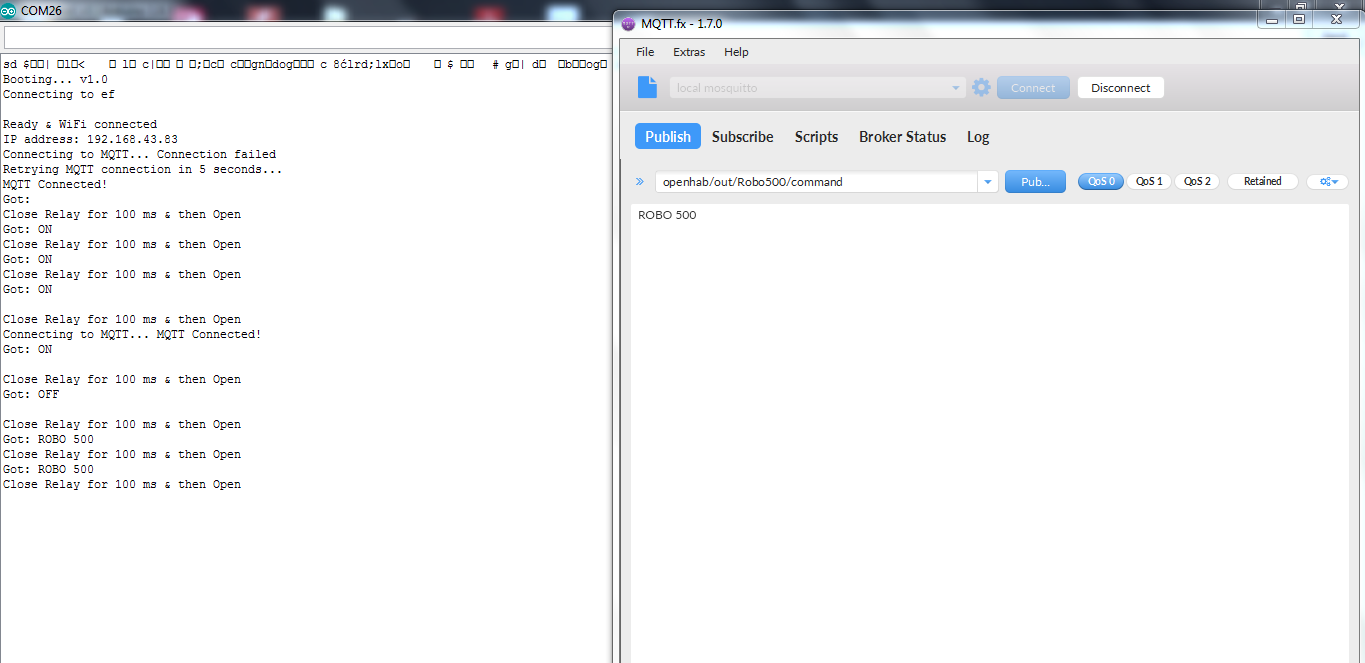

I’ve update Arduino sketch to connect with this broker:
 * Dim - Relay Shield Toggle v1.0
 * Closes the relay for 100 ms, then opens based on OH2 event
 * Relay Shield transistor closes relay when D1 is HIGH
#include <ESP8266WiFi.h>
#include <ESP8266mDNS.h>
#include <WiFiUdp.h>
#include <ArduinoOTA.h>
#include <Adafruit_MQTT.h>
#include <Adafruit_MQTT_Client.h>
/************************* WiFi Access Point *********************************/
#define WLAN_SSID       "xxx"
#define WLAN_PASS       "x"
/************************* MQTT Broker Setup *********************************/
#define mqtt_server      "192.168.1.2"
#define mqtt_serverport  1883                   // use 8883 for SSL
#define mqtt_username    ""
#define mqtt_password    ""
/************************* Constants, Variables, Integers, etc *********************************/
const int relayPin = D1;
const long togDelay = 100;  // pause for 100 milliseconds before toggling to Open
const long postDelay = 200;  // pause for 200 milliseconds after toggling to Open
int value = 0;
int relayState = LOW;
// Create an ESP8266 WiFiClient class to connect to the MQTT server.
WiFiClient client;
// Setup the MQTT client class by passing in the WiFi client and MQTT server and login details.
Adafruit_MQTT_Client mqtt(&client, mqtt_server, mqtt_serverport, mqtt_username, mqtt_password);
// Setup subscription 'Robo500' for monitoring topic for changes.
Adafruit_MQTT_Subscribe InverterBlue = Adafruit_MQTT_Subscribe(&mqtt, "openhab/out/brokerInverterBlue");
/*************************** Sketch Code ************************************/
void MQTT_connect();
void setup() {
  Serial.begin(115200);
  Serial.println(""); Serial.println(F("Booting... v1.0"));
  pinMode(relayPin, OUTPUT);
  // Connect to WiFi access point.
  Serial.print("Connecting to "); Serial.println(WLAN_SSID);
  WiFi.mode(WIFI_STA);
  WiFi.begin(WLAN_SSID, WLAN_PASS);
  while (WiFi.waitForConnectResult() != WL_CONNECTED) {
  Serial.println("Connection Failed! Rebooting in 5 secs...");
  delay(5000);
  ESP.restart();
  // Setup MQTT subscription for Robo500 feed.
  mqtt.subscribe(&InverterBlue);
  // Begin OTA
  ArduinoOTA.setPort(8266); // Port defaults to 8266
  ArduinoOTA.setHostname("InverterBlueChipID");   // Hostname defaults to esp8266-[ChipID]
  ArduinoOTA.setPassword((const char *)"<pass>");   // No authentication by default
  ArduinoOTA.onStart([]() {
    Serial.println("Start");
  ArduinoOTA.onEnd([]() {
    Serial.println("\nEnd");
  ArduinoOTA.onProgress([](unsigned int progress, unsigned int total) {
    Serial.printf("Progress: %u%%\r", (progress / (total / 100)));
  ArduinoOTA.onError([](ota_error_t error) {
    Serial.printf("Error[%u]: ", error);
    if (error == OTA_AUTH_ERROR) Serial.println("Auth Failed");
    else if (error == OTA_BEGIN_ERROR) Serial.println("Begin Failed");
    else if (error == OTA_CONNECT_ERROR) Serial.println("Connect Failed");
    else if (error == OTA_RECEIVE_ERROR) Serial.println("Receive Failed");
    else if (error == OTA_END_ERROR) Serial.println("End Failed");
  ArduinoOTA.begin();
  Serial.println("");
  Serial.println("Ready & WiFi connected");
  Serial.print("IP address: "); Serial.println(WiFi.localIP());
void loop() {
  ArduinoOTA.handle();
  // Ensure the connection to the MQTT server is alive (this will make the first
  // connection and automatically reconnect when disconnected).  See the MQTT_connect
  // function definition further below.
  MQTT_connect();
  // this is our 'wait for incoming subscription packets' busy subloop
  // try to spend your time here
  Adafruit_MQTT_Subscribe *subscription;
  while ((subscription = mqtt.readSubscription(5000))) {
    if (subscription == &InverterBlue) {
      Serial.print(F("Got: ")); Serial.println((char *)InverterBlue.lastread);
