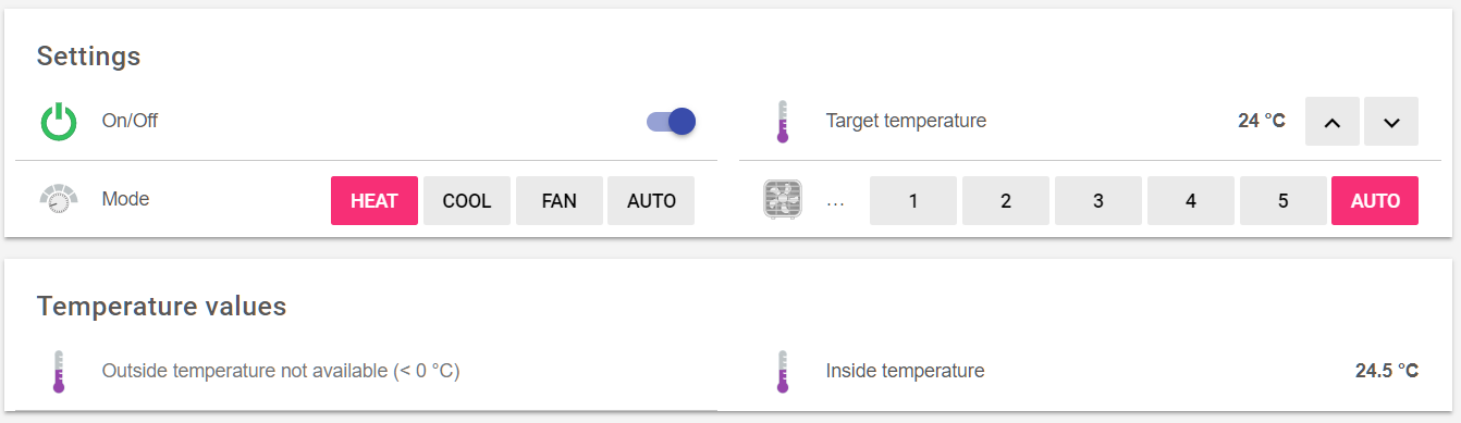

Basic UI:
To change setting from any other rule, postUpdate to the virtual item.
Example; set temperature to 20 degrees: postUpdate(vACsetTemp, 20)
Have fun!
Please report back if this works on other WiFi adapters as well.

Thing
//Daikin Sync from controller to OH
Thing exec:command:daikinSync "Daikin Sync to openHAB" @ "Heating" [command="/var/lib/openhab2/scripts/daikinSync.sh", interval=900, timeout=30, autorun=true]
I also started out with a script, but then I ‘saw the light’ with the HTTP binding :slight_smile:
My interface is, luckily, rock steady, quite close to my router.
Anyway, with this approach it is possible to tune into many variations of this theme.
I found an WEB regex parser most helpful for figuring out the regex transforms.
Also the openHAB plugin for Visual Studio Code is golden. (not M$ VS!)
