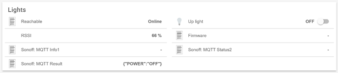

Lets take a Sonoff Basic R3 as an example. Here is what I see in my BasicUI site map:
I can’t switch it on and off from here, but if I paste the command topic from my channel def into MQTT.fx, the Sonoff switches, and the Sonoff MQTT Result field in the site map above updates to show the new state.
