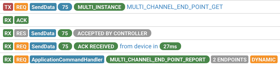

The first problem is the device says it is only supporting 2 endpoints -:
From the log, either it’s incomplete, or it looks like the device isn’t completing initialisation. Maybe you can check if this device configuration etc is the same as the version that’s in the database?
