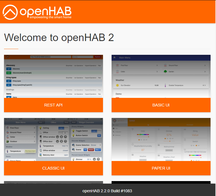

That is your Karaf version. Your OH version can be found at the bottom of the dashboard, or at the top of the Karaf console when OH starts.
Alright, I’m running this one now: 2.2.0-SNAPSHOT Build #1088.
However I might have done an apt-get upgrade since I saved the log above. That version might have been a couple months old.

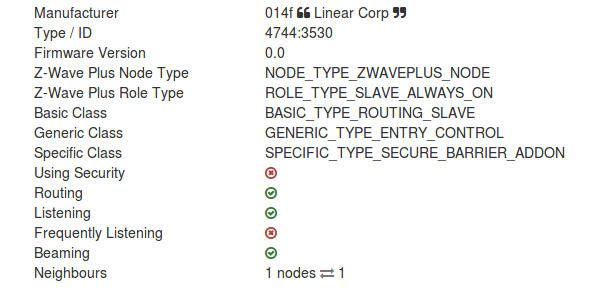

JSON result from REST http://localhost:8080/rest/things/zwave:device:de50aa71:node2, noting z_wave_secure is false:
{"statusInfo":{"status":"ONLINE","statusDetail":"NONE"},"editable":true,"label":"Z-Wave Node 2: NGD00Z-4 Garage Door Controller","bridgeUID":"zwave:serial_zstick:de50aa71","configuration":{"node_id":2},"properties":{"zwave_class_basic":"BASIC_TYPE_ROUTING_SLAVE","zwave_class_generic":"GENERIC_TYPE_ENTRY_CONTROL","zwave_frequent":"false","zwave_neighbours":"1","zwave_version":"0.0","zwave_listening":"true","zwave_plus_devicetype":"NODE_TYPE_ZWAVEPLUS_NODE","zwave_deviceid":"13616","zwave_nodeid":"2","zwave_routing":"true","zwave_plus_roletype":"ROLE_TYPE_SLAVE_ALWAYS_ON","zwave_beaming":"true","zwave_secure":"false","zwave_class_specific":"SPECIFIC_TYPE_SECURE_BARRIER_ADDON","zwave_manufacturer":"335","zwave_devicetype":"18244"},"UID":"zwave:device:de50aa71:node2","thingTypeUID":"zwave:linear_ngd00z4_00_000","channels":[{"linkedItems":["zwave_device_de50aa71_node2_barrier_state"],"uid":"zwave:device:de50aa71:node2:barrier_state","id":"barrier_state","channelTypeUID":"zwave:barrier_state","itemType":"Number","kind":"STATE","label":"Barrier State","description":"Indicates the state of the barrier","defaultTags":[],"properties":{"binding:*:DecimalType":"COMMAND_CLASS_BARRIER_OPERATOR"},"configuration":{}}]}
It looks like there is a database entry for the same unit sold as a Nutone NGD00Z-4 but shown as a Linear.

I have tried both methods of inclusion with the same results. It works, but the JSON result from the REST api above remains unchanged either way. My other nodes all work but I cleared the stick and started from scratch until this one works. So, there is only one node for now. It is my first secure type device.
You must include via PaperUI or HABmin - not via the stick. Clearly it has included, but it’s not included securely - you must exclude the device and start again.

I have done that several times to no avail. I’ve reset the stick and tried this many times. I have started over from scratch. I have the stick plugged into my linux box, with the device touching it and using paper to search - it finds it but never sets the security property to true and I only see one channel. Repeating the process as I understand it will lead to the same result. I have tried to be very meticulous but either I have done something wrong or the device has some incompatibility.
Would it help for me to include the log for the entire process or upload the node.xml?
I’m guessing the entire log will be helpful for @chris. I have two of the exact same devices and I have them working in my setup, so I doubt they are incompatible. Have you validated you have a network security key set, you are in Network Wide Inclusion mode (this is what has worked for me, but may not be required), and that the binding is set to use security for entry devices?
