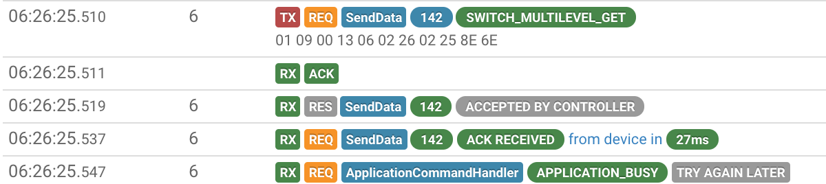

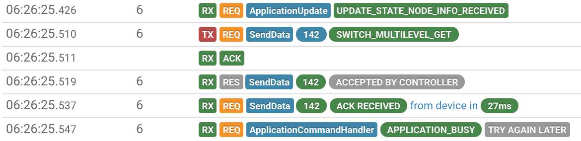

The problem here is that the device is saying it’s BUSY -:
Here you see the NIF being received and the binding sends a GET to find the state, and the device returns that it is BUSY.
Currently the binding doesn’t retry this poll, so there will be no update. To be honest, I don’t think I’ve ever seen a device report that it is busy before…

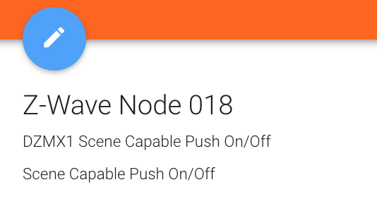

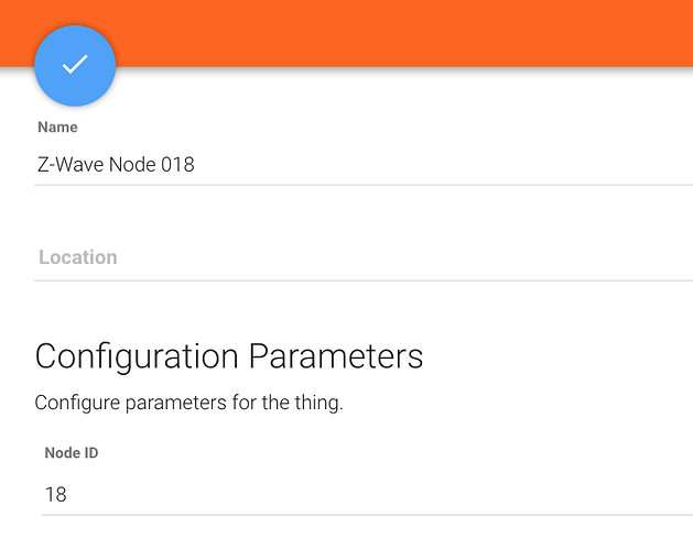

If you go to edit the thing, do you now see the node ID in the configuration parameters -:

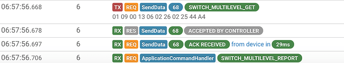

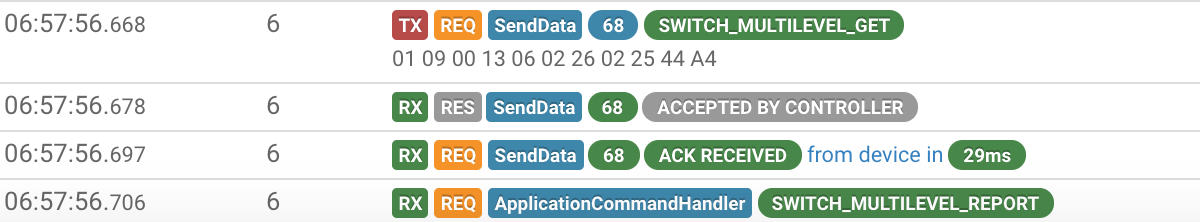

In both instances, the binding is sending exactly the same thing -:
New binding…
Old binding…
