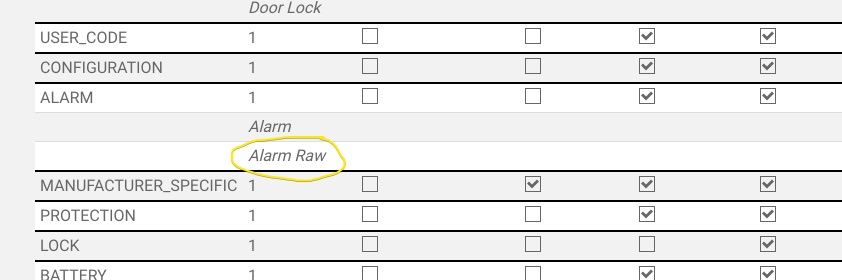

I had a similar issue with my kwiset 910. What i noticed was happening in the logs was that the alarm raw command was getting set then reverting to zero for some reason. I just wrote a rule with a dummy item that has tracks the alarm raw state but ignores the zero state.
@chris, I was holding up until I got a response from you on this, but I saw @mhilbush updated the VRMX1. Are you still processing or did I sneak this one past you?
Not knowing where this would land, I thought I would add the VRMX1 and RZP03 just to be safe. In my logs, I saw those two devices were sending APP STATUS messages.
rule "front lock state"
Item Front_Door_Alarm_Actual received update
if (Front_Door_Alarm_Actual.state == 0){
logDebug("Alarm.rules","The alarm code was zero so we are ignoring it")
else{
Front_Door_Alarm.postUpdate(Front_Door_Alarm_Actual.state)
