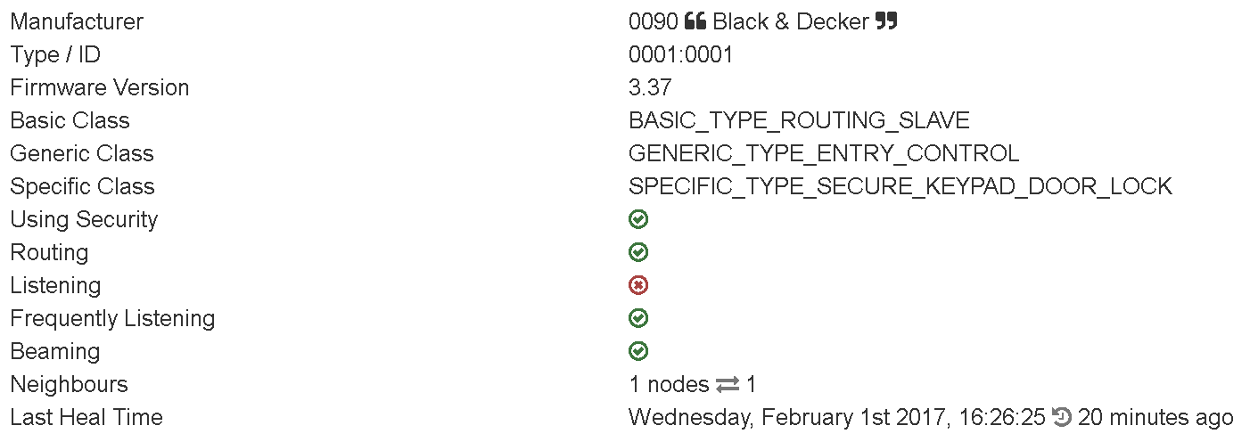

Just want to report that after a stop and start of OH2, my lock now shows the green check mark for Using Security.
I’ll know in a few hours when home if it works.
Nice one :slight_smile:
It works here, Kwikset 916 zwave, Pine64 and zwave module, openhab2 210 snap and that JAR, all is working a treat, now I just need to set it to start on boot…
