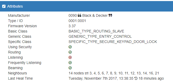

But now that I’m back looking more into my OH2 setup etc, I noticed I can’t seem to control my lock. It shows secured in Habmin, but it does show a red x for listening. I went and manually used the lock to try and wake it up, but uncertain why I couldn’t control it. Habmin shows it online and secured.

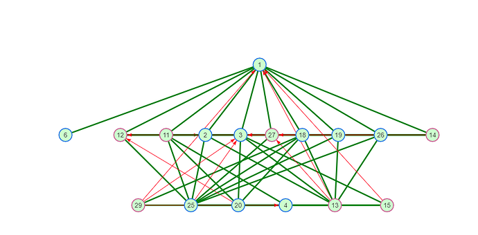

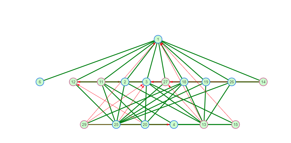

I’m running your latest Oct snapshot of zwave binding. My Z-Wave Network Viewer looks like this within HABmin:
The red circle means the device is a battery device.
It means it’s a one way link.
It synchronises the network with the master controller - if you don’t have multiple controllers in your network it should do nothing.

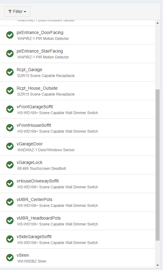

Sorry - I’m not sure what you mean - or more to the point, why you mention this. Isn’t that normal and what you want? This means the devices are online - that must be good, right?
Thank you so much for the clarification. Are one way links bad or is that just a feature of the specific devices?
The last point about my THINGS green, just wanted to say there was no problems with any items as i assumed the red stuff meant problems. This was just an informational post.
No - not in their own right. In an RF environment, especially in the home where there are lots of noise sources, walls, multipath issues etc, it will definitely happen…
However, clearly if a device has no route through to another device, then it’s a problem.
As an example, node 29 has a one way link to node 1. This means node 1 can receive node 29, but node 29 doesn’t directly receive node 1. However, nodes 18, 19 and 26 can all act as repeaters - ie there are green lines (bi-directional links) linking node 29 and node 1 through these 3 devices, so this is a good link as the controller has 3 options for routes to node 29.

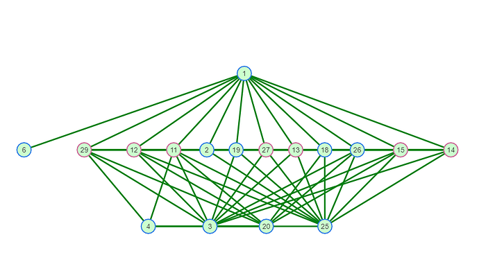

Thank you - This makes a lot more sense and is logical now.
I guess things updated from my previous post as the mesh looks much better now. I just never seen all that red before and was confused.

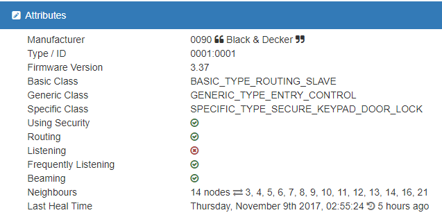

Ok, so kinda strange. I know in the past I was able to control my lock, but had let my time with OH2 slip and now back looking at everything, upgraded OH2 and the Binding here to the latest, even removed my lock from HabMin and re-added it.
However, Habmin is not reporting the either door status or battery level, yet everything seems correct in Habmin and not seeing any issues. Habmin even says it did it a heal on the lock device this morning. Its been over a day without any door or battery status.
And the batteries in the lock are fresh new batteries. I can manually enter lock codes to lock and unlock the door.
The batteries in the lock may have been previously dead for a week or more. Is it possibly I actually need to unpair and repair the lock to the controller?
I stopped OH2, confirmed the secure key was correct, deleted the xml file, and restarted and rescanned the device.
Took a few minutes for OH2 to see it and wake up the device, but now working again.
