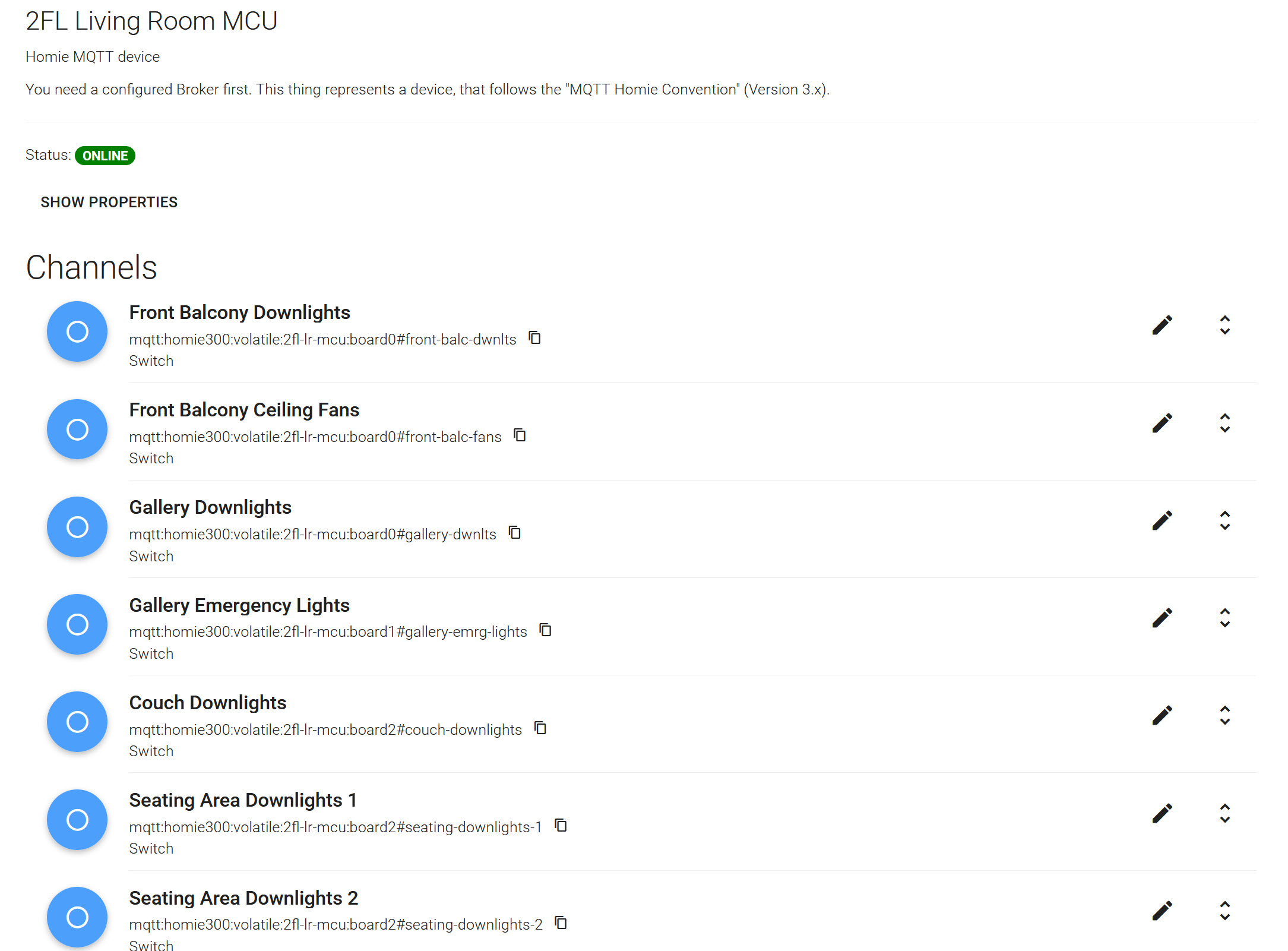

Here’s what it looks like in OH2.5:

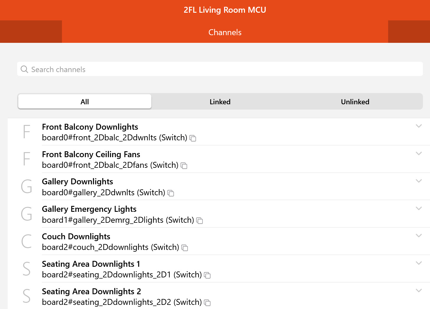

And here is what it looks like in OH3.1:
For some reason hyphens and underscores are displayed as the hexadecimal character code rather than the character itself!
This is not pretty and it makes it difficult to read. Surely this cannot be the intent? Hyphen and Underscore are both part of the standard 7-bit ASCII set from the 1960s, I think it probably safe to use them
I’m actually more worried about this than the previous issue, because wouldn’t fixing this in a future version invalidate linked items?
