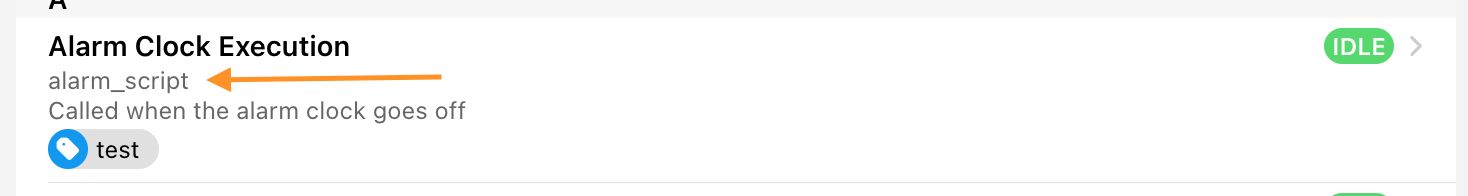

It wouldn’t show up there. A Script is a rule consisting of a single Script Action (no triggers, no conditions) and has the “Script” tag. I’m not certain it’s even possible to create a “Script” from a .js file.
Your rule should show up under Rules.
Again, it probably shows up under Rules. If it doesn’t show up anywhere there is something else wrong.
Yes, create a rule that is triggered by commands on an Item used by the oh-button widget.
Or look under Rules to find the UID for the rule (it’ll be some random text unless you specify it) and enter that UID as the rule to run for the “rule action” on the oh-button widget.
