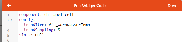

I found the error:
When defining the “Trend Line Sampling” the number in the yaml is interpreted as string:
This is not working.
The quotes has to be removed like here:
After that it is working as expected.
