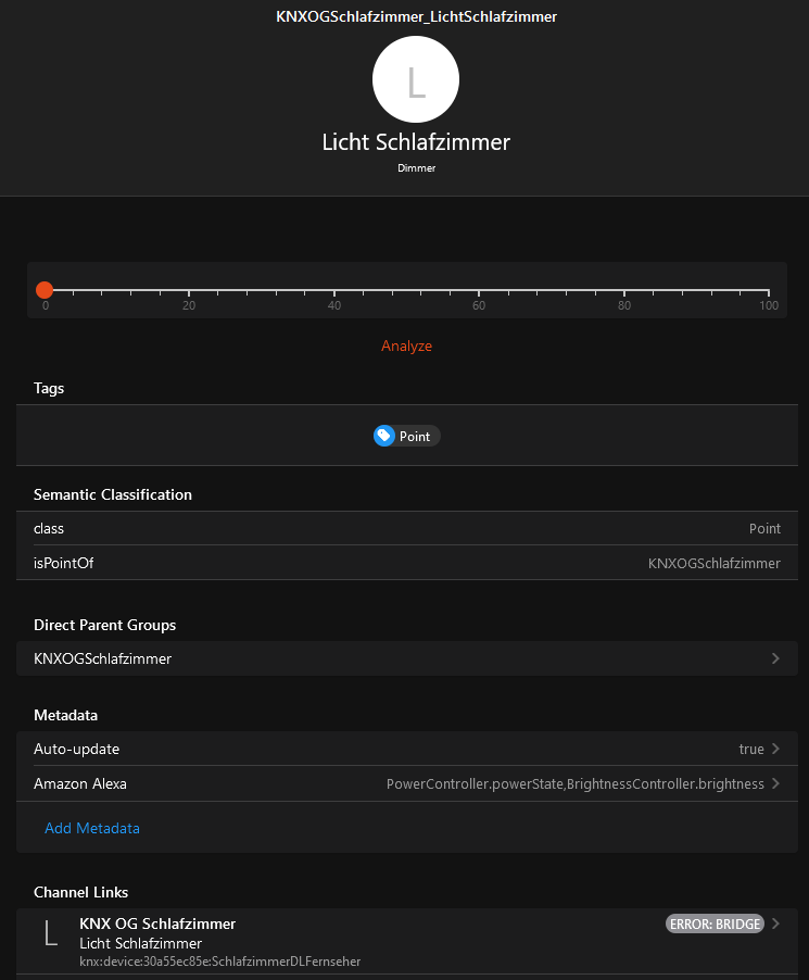

- I used “add Equipment to Model” and now have a bunch of “raw” items
- Now I want to add metadata to my items like:
3.1. force auto-updates
3.2. alexa-API attributes
3.3. expires
what I am missing now is a bulk update mechanism, so that I can find “all dimmer items” and apply the alexa attributes or use “auto-update” on all my KNX-items, etc.
