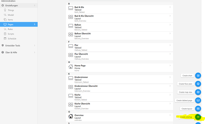

Yes ,if it’s still being used ,how do I create a site map in OH3 or is that same as a semantic model?
I’m using the app for iOS and it’s running fine. You can define your sitemaps in the same way(file based) as in OH2.5 or via the new UI.
On the semantic page or ?

So when I save site map it will then show on the app?
That’s right

Where is the sitemap saved on OH3

In the same place as before (assuming that you want to use textual configuration) /etc/openhab/sitemaps/
