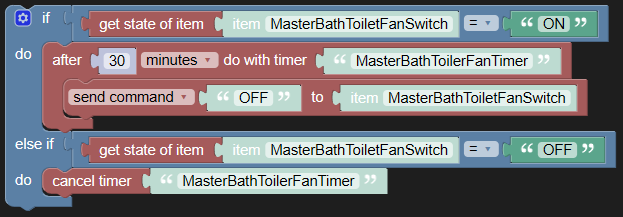

In the meantime Timers have been added to blockly available since 3.2.0. See Blockly Timer Support
For best practices, is it necessary to cancel timers? For instance, a fan switch is changed and ON triggers timer. If the fan switch is manually turned off, what happens to the timer? Here is what I have, and it works fine, just wondering if second part (cancel) is necessary.
Definitely a nice addition since expiration timers don’t work great with zwave devices over long periods.
If you right click on the block you can see the help URLs that I added during the implementation which takes you in this case to Timer-Documentation. It says here
  • cancel: prevents the scheduled timer from executing. Most of the time cancel is used used in conjunction with setting the timer handler to null as a convenient indicator that some previously defined timer is now finished with. However setting the handler to null does not interact with the timer itself.
Hope that helps a bit.
