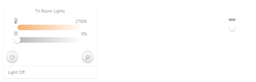

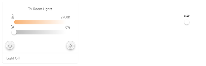

This btw does not work for me. I have to put the whole property in " for this to work
This looks and works awesome, thanks for sharing! I did notice that at least on mine with a range of 2700-6500k for temperature, it seems that going higher than 3900 the slider goes off the widget and at the 6500k mark it’s way off. Any ideas how to fix that?
I only noticed this behaviour in the editor when I resized the preview panel. Have you resized your window by any chance? Does a page reload fix it?
I had my browser maximized the the whole time, but shrinking it works and then it seems to work fine at any size except for if I then maximize it again and then the 6500k boundary stays at wherever it was when I shrunk the window so I can deal with that. On my phone (edge chromium browser) it seems that the upper boundary ends at the T in TV in my screenshot. Not sure how or if I can fix that since it seems to be a browser rendering issue
Hmmm, this is really weird. I cannot reproduce this issue here so I don’t really know what else you could try
I will paste you my current code asap that has some minor changes compared to Rainer’s suggestion above. Maybe this helps!?
This is the code I am currently using which works fine for me:

The v2 version seems to have fixed all of my issues, thanks!
You may also want to checkout v3. I’ll also update the code in the first post.

Hey,
I really like your widget.
I modified it a little bit, to work with the dimmer item for the hue bridge color temperature (0 - 100%). I also changed the text of the actual color temperature to the following one, because the item state is often NULL.
text: '=items[props.temperature].state == "NULL" ? "-" : items[props.temperature].state + "%"'
I have the problem, that sometimes the slider is out of the card (tested on Mac Safari and iPadOS Safari):
tardismechanic had the same issue (see above). He said that v2 fixed this for him (code also above). You may want to try to start with that and add your charges one by one to see what breaks the widget.
My approach to the color temp as a percent was to create a ColorTempK that’s “write only” to the percent channel item that I linked to the widget and this rule. My two items are LightName_ColorTemp and LightName_ColorTempK. There’s probably a better way to do it, or possibly in the widget itself but I don’t know much about doing stuff like that in widgets (yet) so this works for me.
#Get the base item name
tempName = event.itemName.split("_")[0]
#2700 is the lowest temp, so make that the new "0"
colorTempNormalized = float(str(ir.getItem(event.itemName).state)) - 2700
# Divide the "normalized" temp by the difference between the lowest and highest values
# In my case that's 2700 and 6500, so 3800 is the result. Make that a percent (*100)
# and invert that percent (100 -) because in my case 2700k should be 0% (on the left end of the slider) and 6500k
# should be 100% (on the right end of the slider)
pct = 100 - ((colorTempNormalized / 3800) * 100)
# round off the decimals because I don't care about them and post it to the true
# _ColorTemp to make the actual change
events.sendCommand(tempName + "_ColorTemp","{:.0f}".format(pct))
This way the widget shows 2700k - 6500k as a slider and doesn’t bounce around when you make a change like with mine (zwave bulbs) when I change the color temp, it posts the change to the binding and the binding immediately sets it to NULL when the change it made
