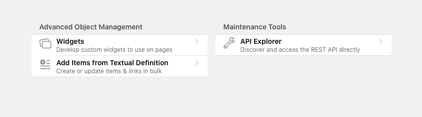

I just created a new OH3 (docker) container (version 3.0.0 Release Build) alongside my already running OH2 container and I was wondering how I can enable the developer sidebar.
I am logged in as the admin user and under ā€˜Developer Settings’ → ā€˜Maintenance Tools’ there is no option ā€˜Developer Sidebar’ as I saw it in the release candidates before.
Am I missing something that needs to be done in order to activate this feature?
