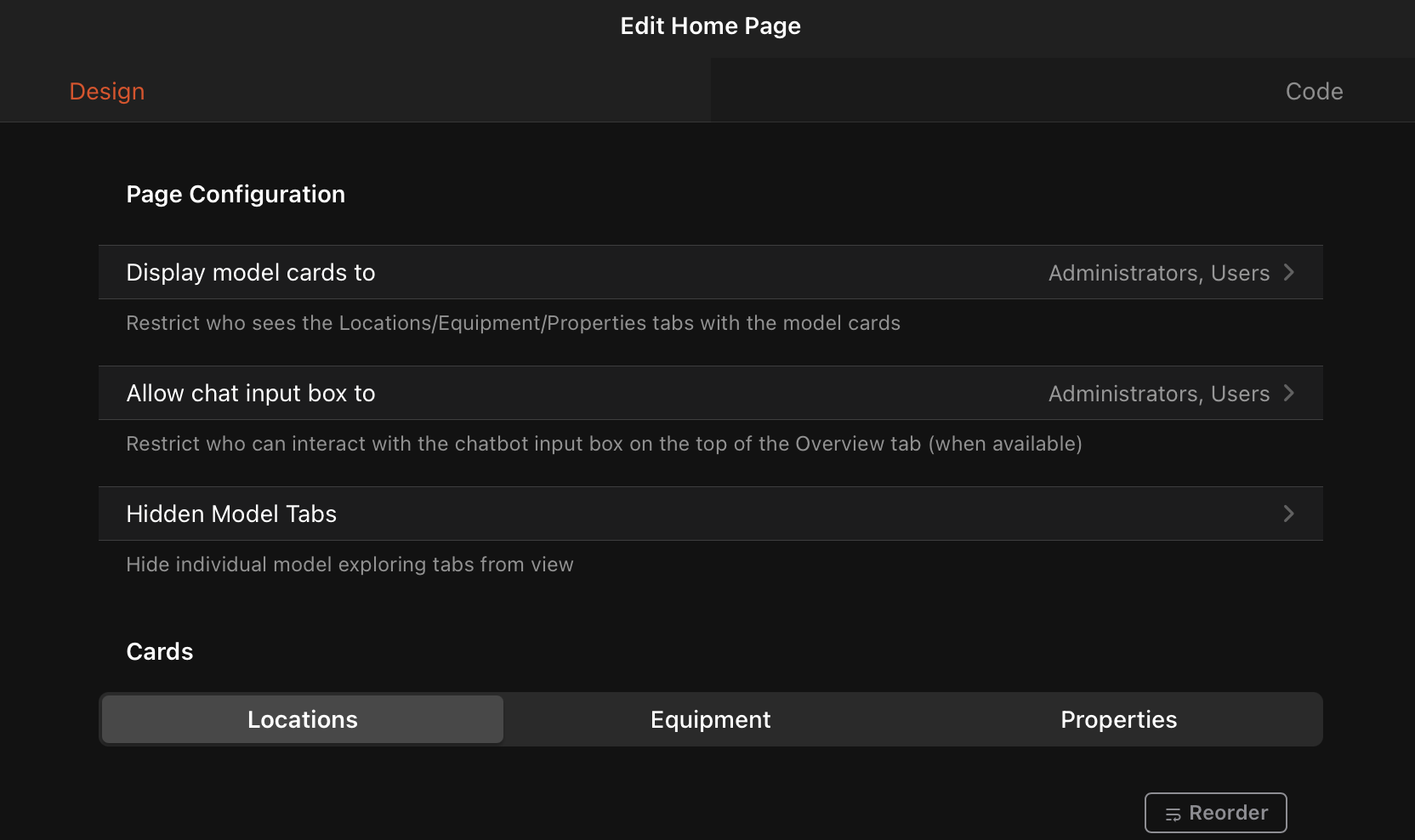

It took me forever to try to figure this one as well. I had to watch the Openhab 3 video on youtube to watch the demo. At the top of any page (except Overview), there is a “Sidebar & Visibility” menu (3rd line from the top), open it and set “Show on Sidebar”.
Ok, this is my understanding so I may not be 100% accurate here but the “Overview” page is the first tab on the page visible when you click the OpenHab “box” in the upper left corner. The “Home” page is the next 3 tabs (Location, Equipment, Properties). Using the Hidden Model Tab you can hide the extra tabs.
