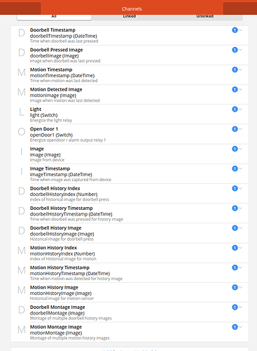

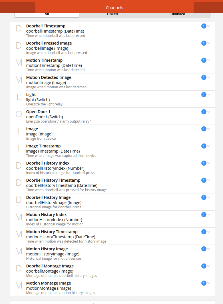

After the upgrade to OH3, I noticed that I’m missing the most important feature about the doorbird doorbell, namely the ‘Pressed Key’. :blush:
Weird thing? The doorbellTimestamp, doorbellImage… are fe working. When I check the channels I can’t find the channel ‘doorbell’? Any idea what I can do to resolve this?
When doorbell is pressed:

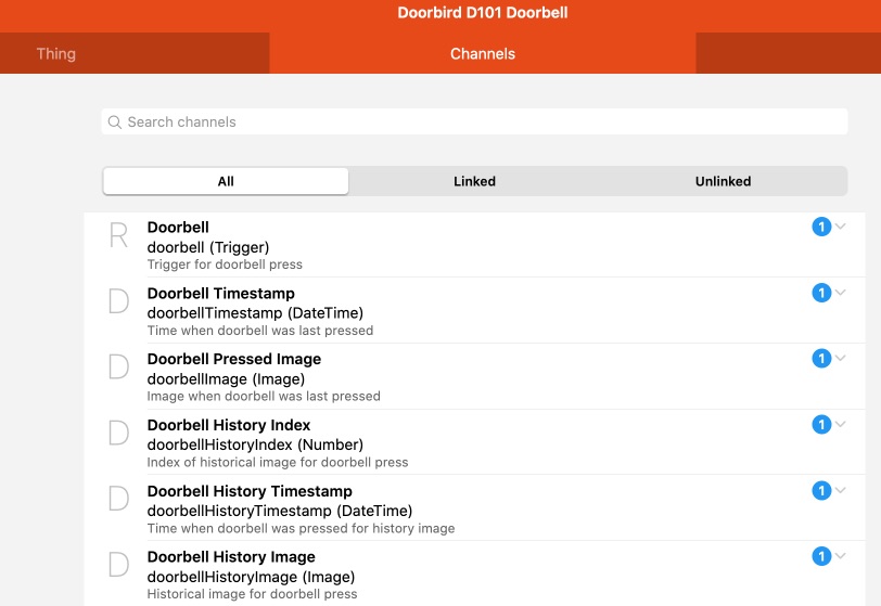

Hmm. That’s pretty strange. It’s showing up for me.
