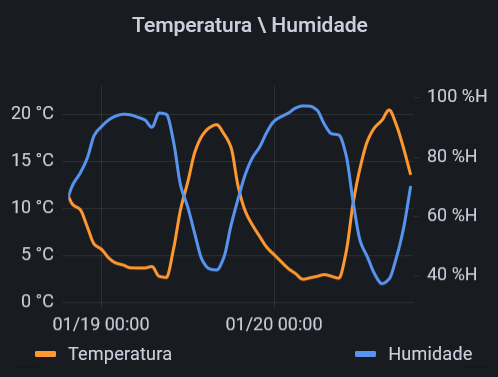

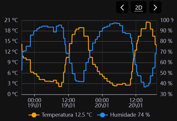

I have the following situation:
I’m trying smooth echart like grafana but i can’t.
Grafana:
imagem
Echart:
imagem

Could you share your data points (with the Developer Tools > API Explorer, then persistence) or by opening the browser developer tools and try to find the /rest/persistence/items/YourItem call. The trick is to figure out what is returned by the API. For instance if you have a data point every minute regardless of the gap between two points in your InfluxDB, then you can’t smooth the chart with ECharts options because as far as it is concerned you have a data point every minute.
Yes, its true. I have data point every 15minutes. With graphana he have a function Group By time() we can change data information received time. With Echart i can’t find that function.
So i get your advice and i will change persistence strategy for longer time example 1hour.
