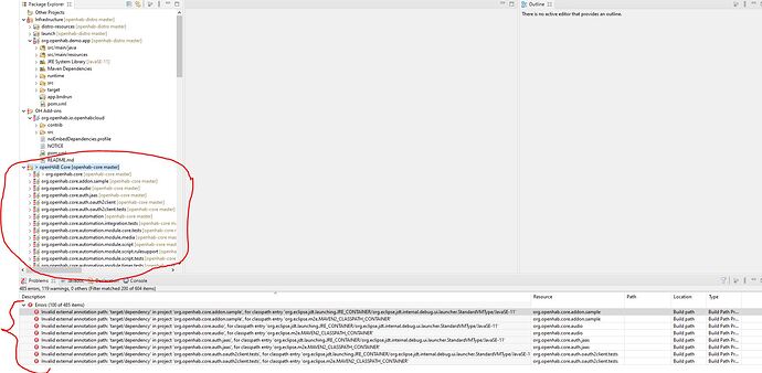

I have problems with Eclipse IDE configuration for OpenHAB 3 Developing/Learning …
When Im install it Im select:
openHAB Development
openHAB Add-ons
openHAB Web UIs
openHAB Core Framework
and on all select version 3.0
After installation Im wait few hours to complete building/downloading(Im doing this on old slow i5 notebook) import maven project from existing path but I have a lot of errors…

After the first run all parent tags in pom.xml files are ‘incorrect’
Installing the m2e connector for the Maven Dependency Plugin
(com.ianbrandt.tools.m2e.mdp.feature.feature.group) solves this,
but I am not sure if this is the correct solution
Then it misses model items, running ModelGen.launch (again?), fails with errors, but seems to solve these errors.
But now I get many unresolved types.850 errors in total.
The first one being:
AllConfig cannot be resolved to a type
PersistenceModelManager.java|
org.openhab.core.model.persistence/src/org/openhab/core/model/persistence/internal|line 134
Do any of the maintainers have an idea?
