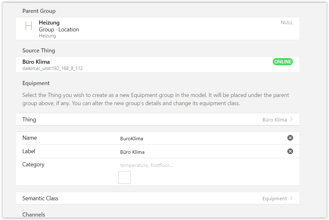

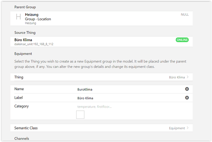

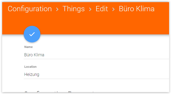

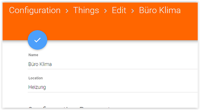

For example: In OH 2.5 I have the thing “Büro Klima” with the location “Heizung” After update I didn’t have the location “Heizung” in OH 3.
So I created the location Heizung in OH 3 an added equipment from thing “Büro Klima”

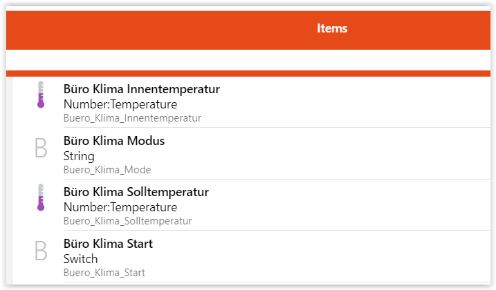

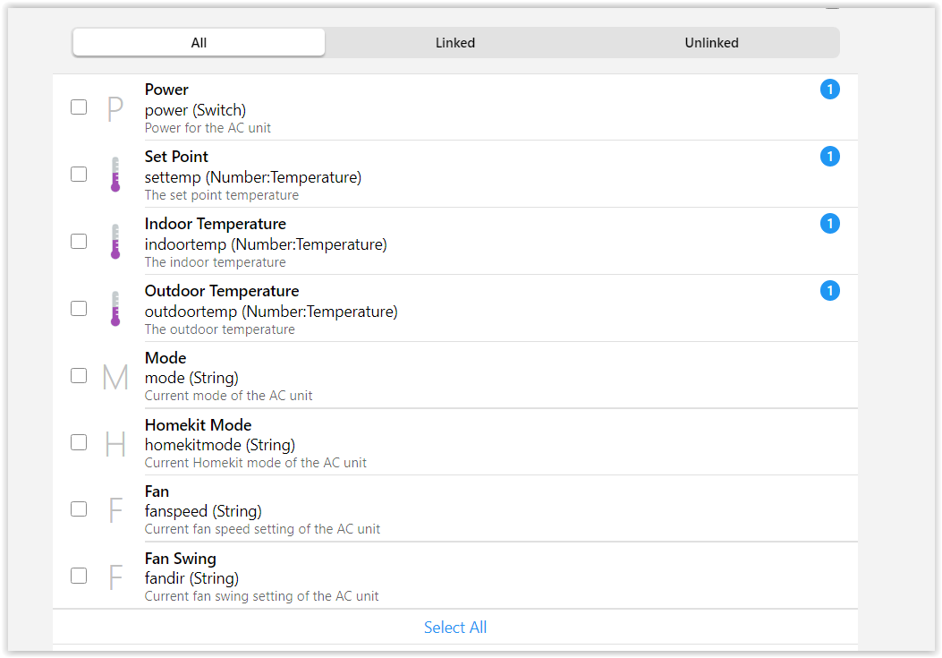

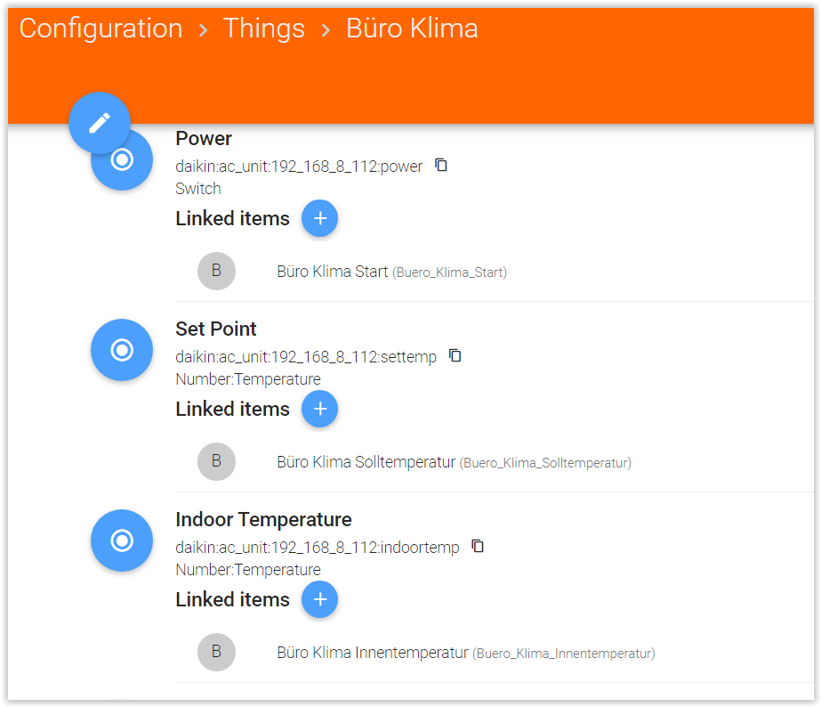

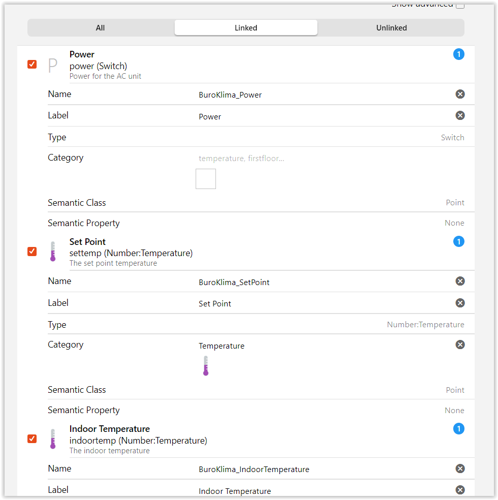

In OH 2.5 I have the Item “Büro Klima Innentemperatur”. While adding the equipment to the location Heizung I could only select item indoor temperature. I could not add the Item 'Büro Klima Innentemperatur".

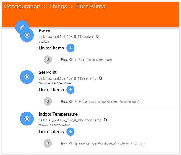

Please show us your thing and item configs of both, oh2.5 and 3.0.
Without those information, it is nearly impossible to see what‘s causing your issue.

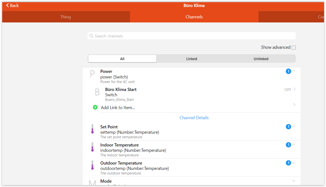

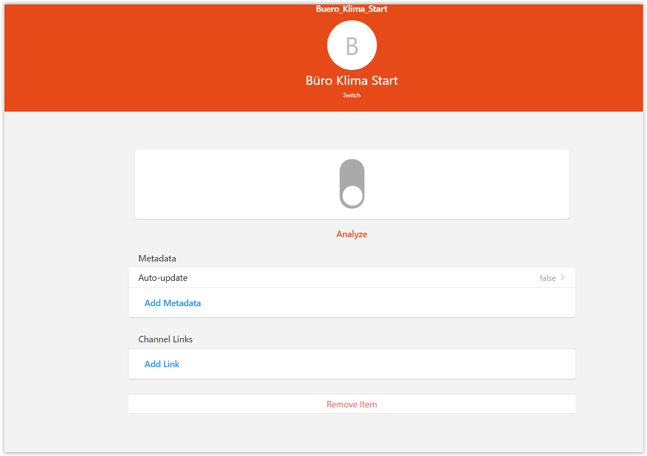

Could you please check, if your Items show any links to channels.
Looking at your screenshots, seems that none of your old items got linked to the thing channels, instead new items had been created.
