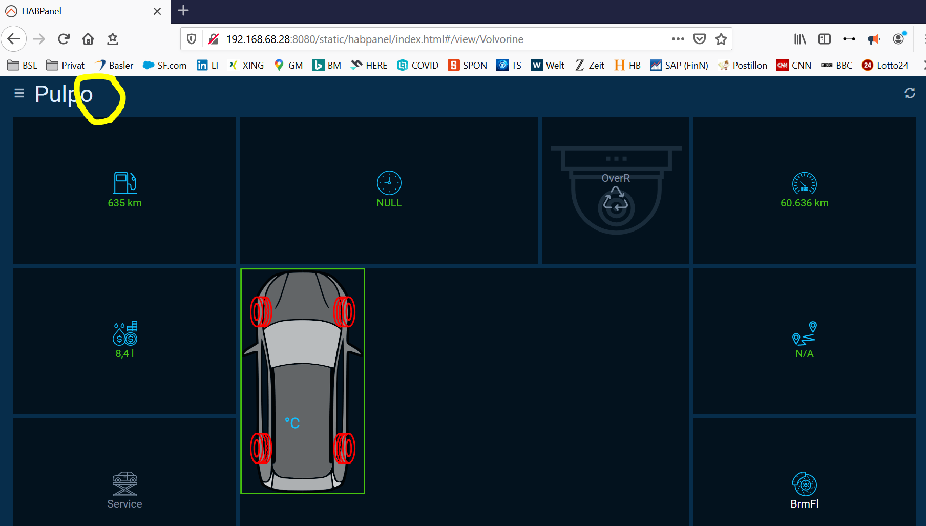

Hi Guys,
I tried this the same way (and did before when starting from scratch).
Unfortunately I am not able to open the config - so editing is impossible:
The edit button does not show up (yellow circle):
 ![image](https://community-openhab-org.s3.dualstack.eu-central-1.amazonaws.com/original/3X/5/f/5fedcaaa36e2f5aaea0351f227d7505837912a88.png)
neither the settings wheel on top right of the screen shows up.
This is the case for both:
[http://192.168.68.28:8080/habpanel/index.html#/](http://192.168.68.28:8080/habpanel/index.html#/)
as well as
[http://192.168.68.28:8080/static/habpanel/index.html#/](http://192.168.68.28:8080/static/habpanel/index.html#/)
with all my stuff in /etc/openhab/html/habpanel…
(I extracted the most recent habpanel package here).
Any suggestions what might be wrong?

Just change the “view” within the URL to “edit” and you’ll get to the edit page…

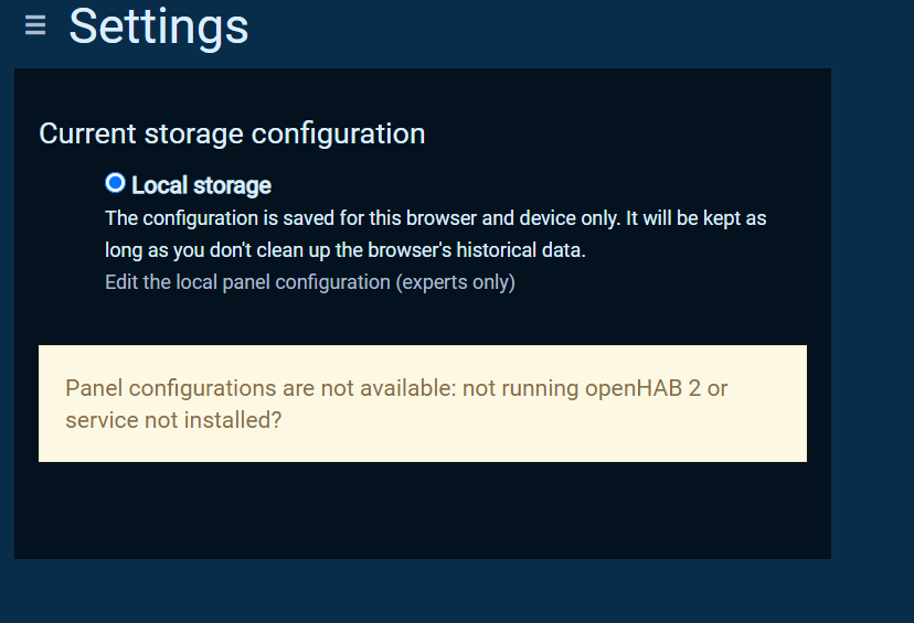

Thanks a lot.
I didn’t know that trick.
Unfortunately changing the config ist still not possible:
 ![image](https://community-openhab-org.s3.dualstack.eu-central-1.amazonaws.com/original/3X/d/e/de49626a5a53428daaeff42821627a1569ffd8d7.png)
I can open “Edit the local …” and can paste my previous config.
According to the reponse it has been saved, but I cannot store it locally under a new name.

Just to close my open case here:
I ended up with a black screen instead of any configurable panel.
(this issue can be found several times here in the forum when looking for black screen on habpanel.
I just soved this by shutting down OH3, deleting the (potentially corrupt) config file which is nowadays this one (OH3) and starting OH3 again:
`/var/lib/openhab/jsondb/uicomponents_habpanel_panelconfig.json`
Too early happy:
After the steps above was able to import my OH2 json.
However, because I use custom icons I usually extract the habpanel stuff into /etc/openhab/html/habpanel, which I also did.
Unfortunately after that (and fixing permissions with openhabian-config to be on the same side), I was not able to change anything on the habpanel config anymore:
So, what could prevent me from editing the config?
