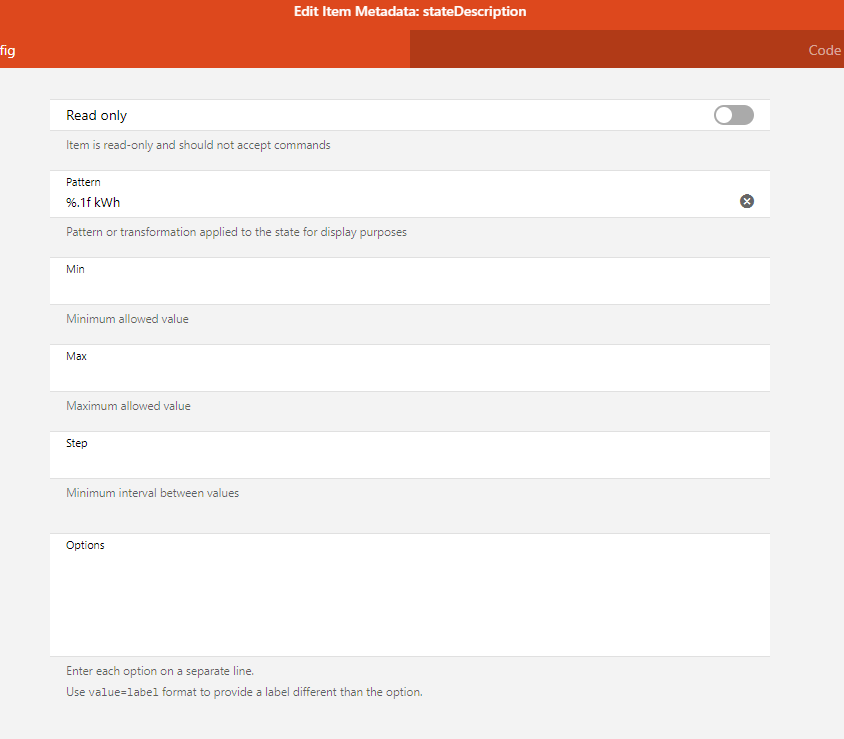

After Creating item you Add Metadata / State Description / Pattern
Wow, that was easy! I guess, I missed this in the tutorials.
Thank you!!!

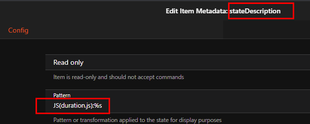

Without scripting it’s not possible. But the script itself is quite easy.

Save that e.g. as duration.js within the scripts folder and add it within the state description metadata of the item that reports seconds.
But the script converts into days/hours/minutes/seconds and not only hours
thank you for the quick reply! Have the script slightly adjusted since the input variable is seconds with me. Functioning now super!
