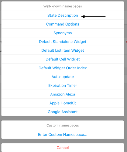

You can’t get the label in the traditional way it’s defined. But I think you can set a label by setting the “State representation” metadata on the Item. Then you can use =items[props.propItem].displayState. Note, if you don’t have the metadata defined that will generate an error. So it might be good to use a ternary operation to check if that is defined and if not fall back to just show state.
