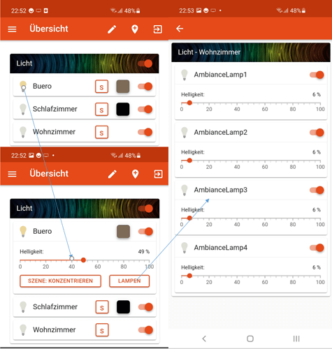

i have made my first custom widget and want to share it with you. I hope you like it.
Maybe you can help improving it, there are some points under construction
Also tips e.g. regarding best practice are welcome, because the openhab, yaml, javascript world is new to me.
Design goal:
- Widget optimized to be used on mobile phone using opanhab app
- Most important stuff should be available in default state
- Access to all options shall be available.
- Self configuring from model (I loose overview of my items w/o model)
screnshot default state / after pressing lightbulb / after pressing button “LAMPEN”:
Functionality default state:
- lightbulb indicates dimmer value and opens further settings.
- S-Button: Select Scene
- Colorpicker
- On/Off Switch
Configurable:
- card header background image
- card header title
- card header “All lights switch item”. If no item is configured switch is not shown.
Everything else is generated from the model information.
The model must follow the scheme:
- The Hue Room must be an equipment under a location (category: light or colorlight; semantic class: lightbulb)
- The single bulbs in the room must be child equipments of the room equipment (category: light or colorlight; semantic class: lightbulb)
- The items must have default hue names in german (can be adjusted in the widget code).
- Switch and dimmer items have to be setup manually with “_Betrieb” and _“Helligkeit” for each single rgb lightbulb (not for rooms).
- Switch items have to be setup manually with “_Betrieb” for each single rgb lightbulb (not for rooms).

Open Points (Tips/Hints are appreciated.):
- Colorpicker for RGB is very laggy or not responding.
- I need a colorpicker supporting color temperature for the ambient bulbs. It should match the rgb colorpicker design.
- Probably gaps outside of my use case (other hue bulbs, room configurations, other vendor lights, etc)
best regards
Peter
