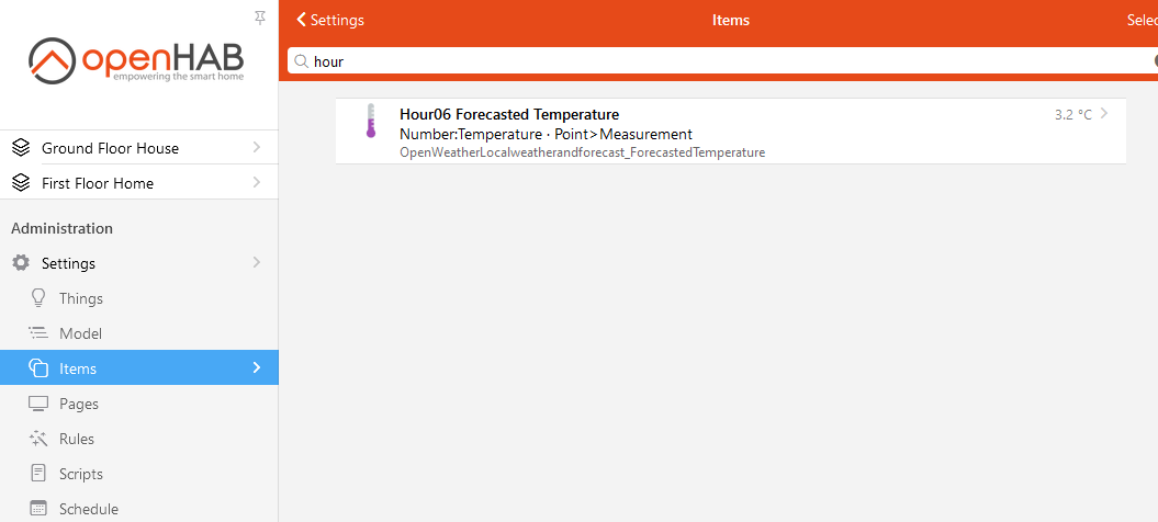

I then clicked on the items tab in the left column and search for hour.
I should see the two new linked items
But i only see the last add linked item !!!
Going back to the things tab, this is what i see
Hours03 has disappeared and i only see 2 times hour06 !!!
The Hours03 item has suddenly changed to hour06
Tried with other items to link and i always got the same result. Only the last linked item is kept, all the others are not found.
